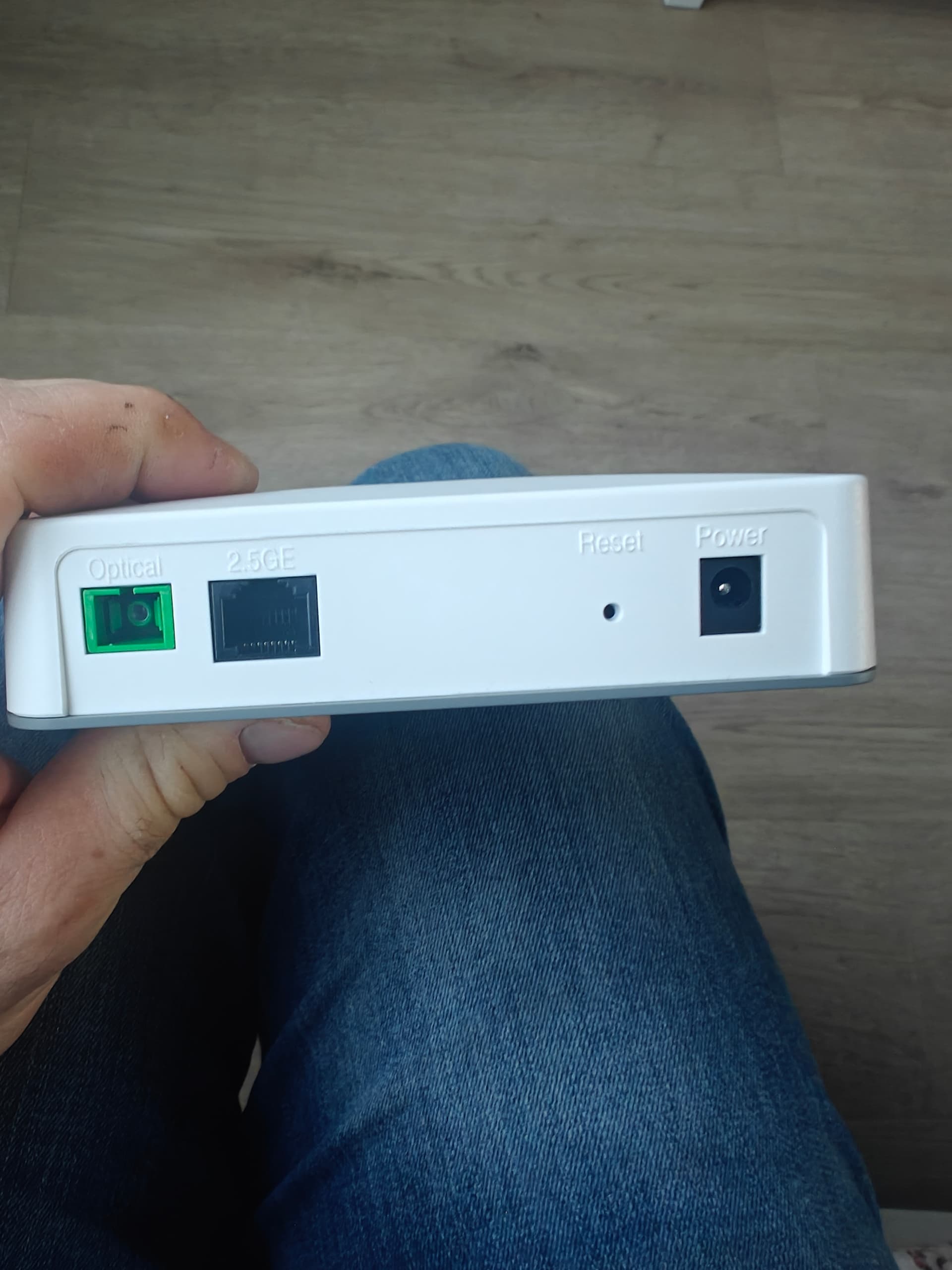

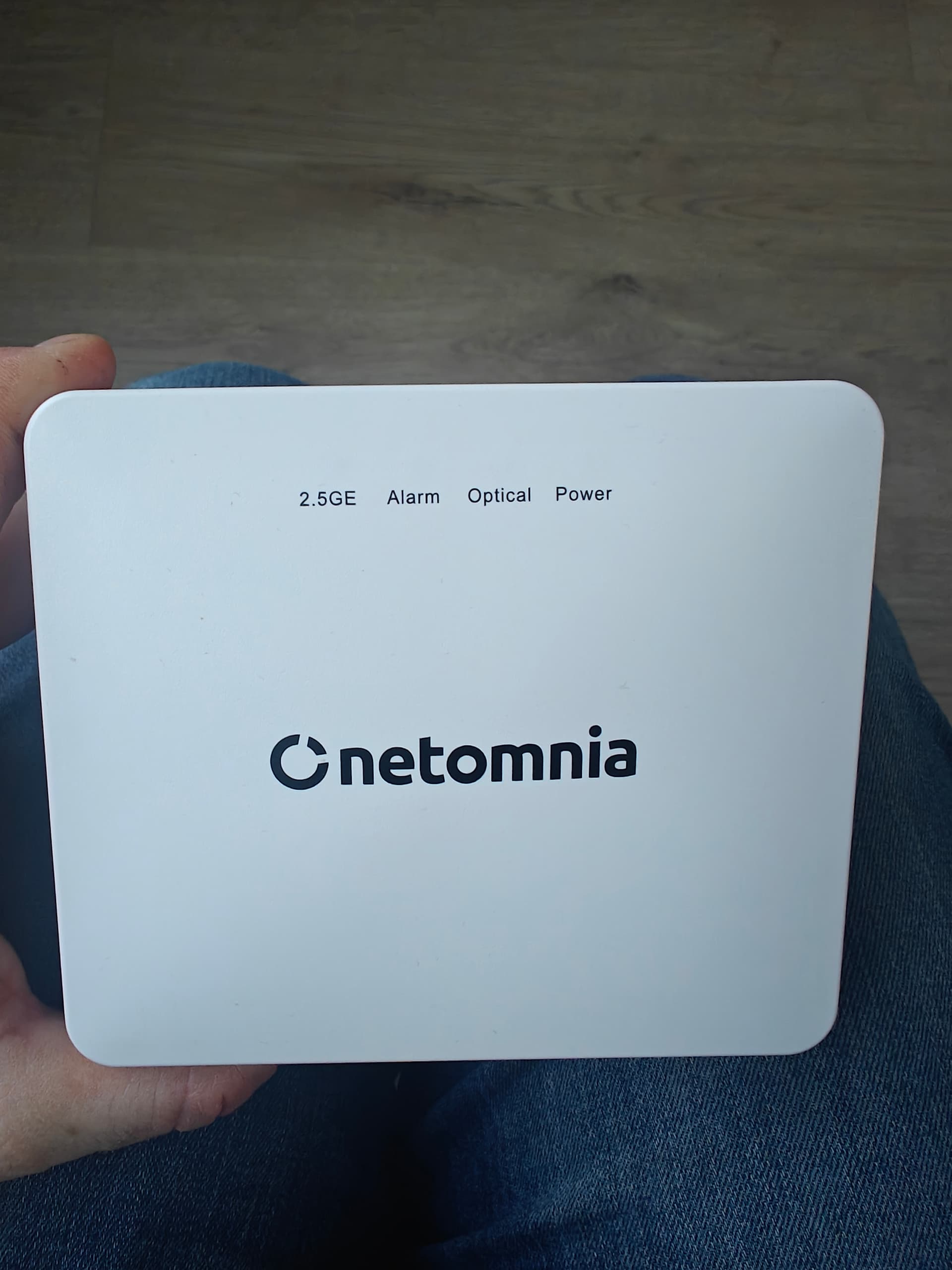

Optical network terminal (has dynamic IP) connected from 2.5G Ethernet cable to WAN port of to GL-AX1800 flint router. I am Getting working internet from AX1800 router without any problems etc . Downloaded VPN configuration from Surfshark website and uploaded to GL-AX1800 router, it's working without any problems as a client. At the same time have also turned on AdGuard so both are working together, no problems.

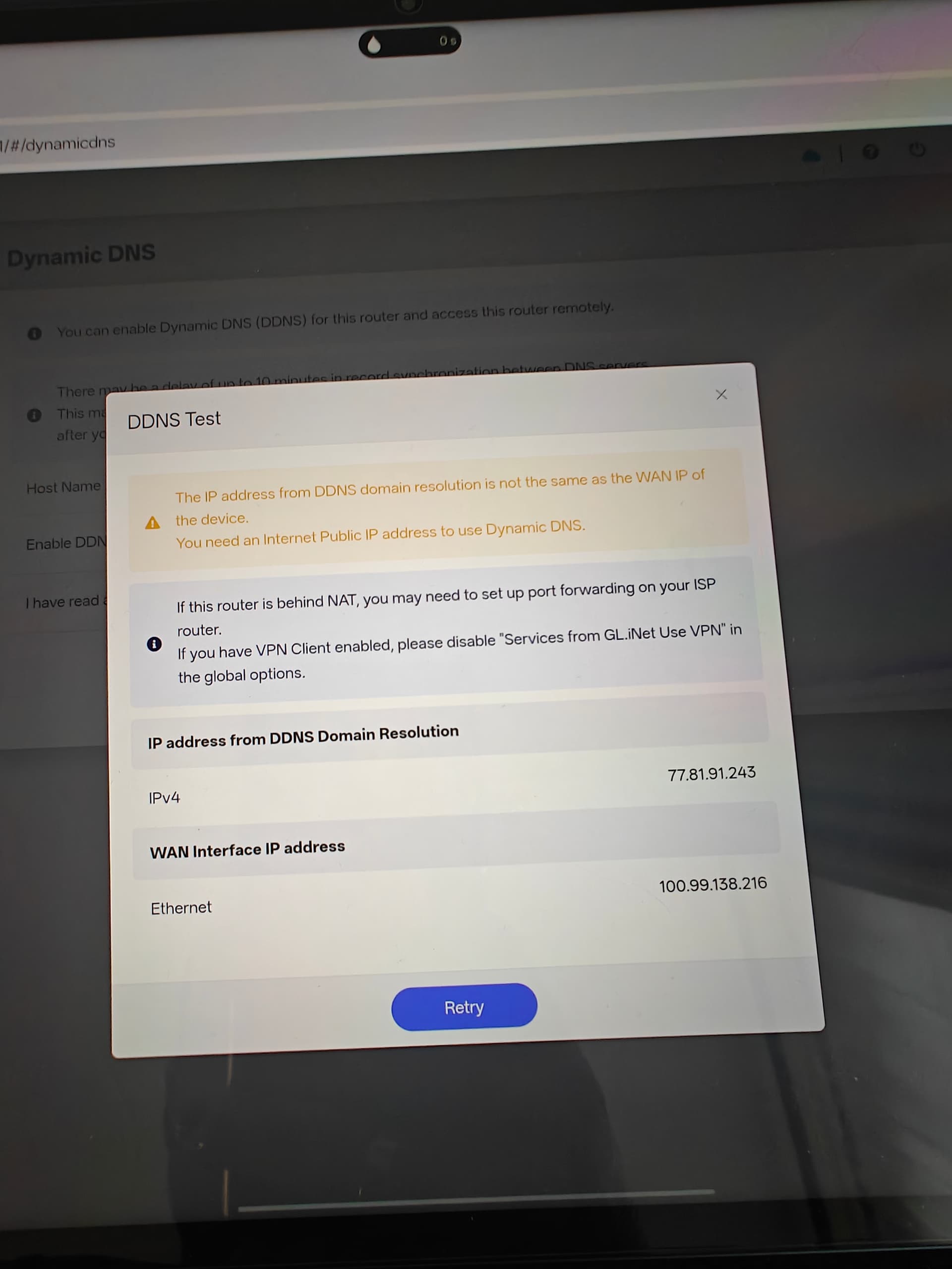

You cant remote in via VPN because you are behind CGNAT. You can use tailscale which can bypass CGNAT or ask your ISP to provide you with a Public IP address.

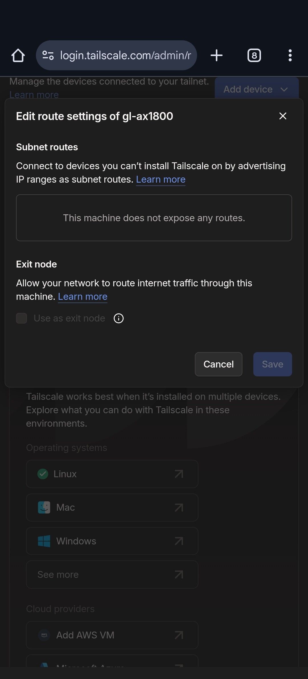

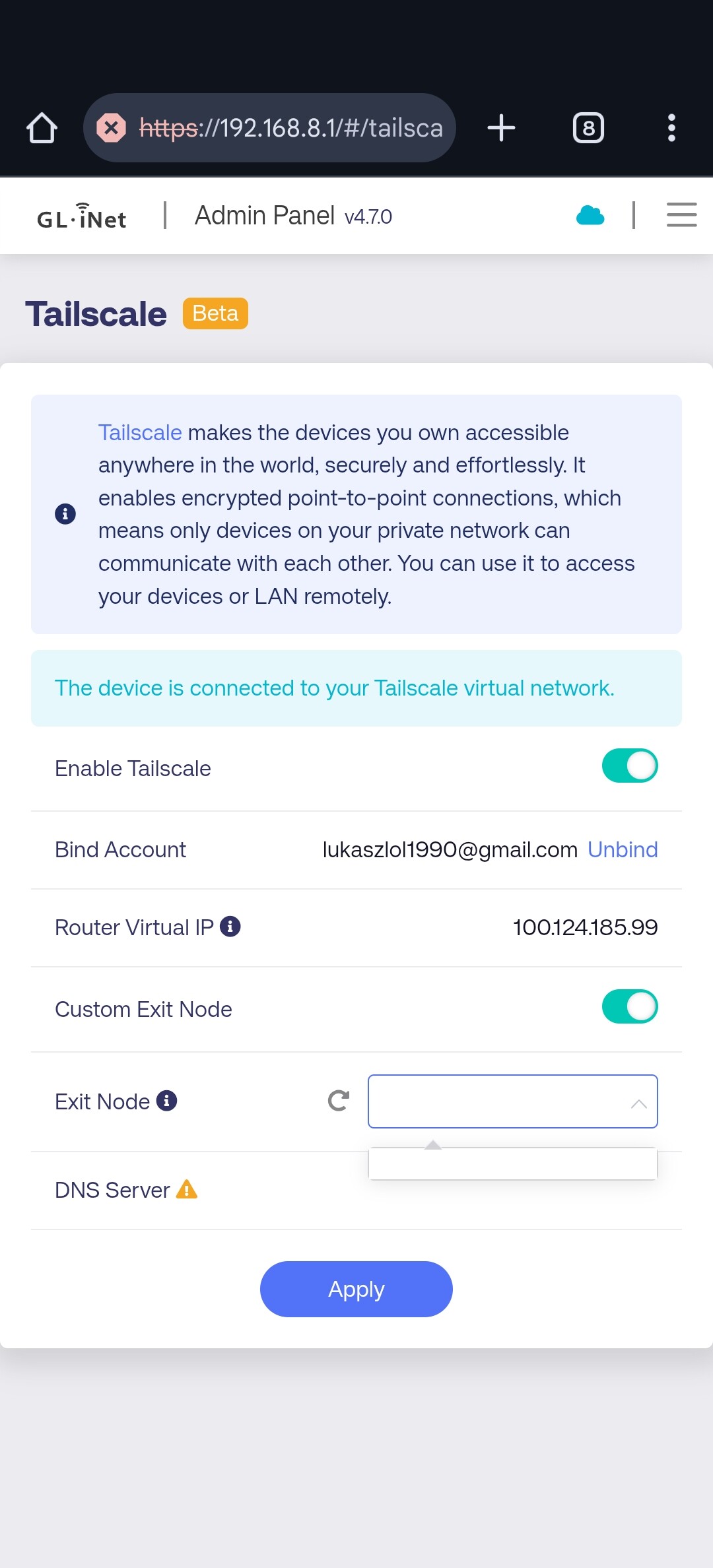

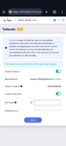

On router can't set up exit node, on admin console in tailscale website account can't turn the exit node on ….
Native support for using our routers as Tailscale Exit Nodes is not available at this time.
However, you can manually enable exit-node functionality by following the community guide below:
Additionally, Tailscale does not currently support cascading VPN tunnels. Traffic forwarded to the router through Tailscale will bypass any active VPN client on the router and will egress directly through its WAN interface.

What you can't use is the Wireguard or OpenVPN server section to allow your devices that are external to your network to connect to your home VPN server because you are behind CGNAT.

Again, the problem you have is your behind CGNAT. You can however achieve your goal to get a VPN connection whilst on the road by connecting back home to the glinet router via tailscale, your devices connecting back to your home router will just have to appear / use your ISP WAN address, which is usually the normal case anyway.
