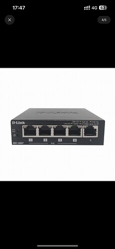

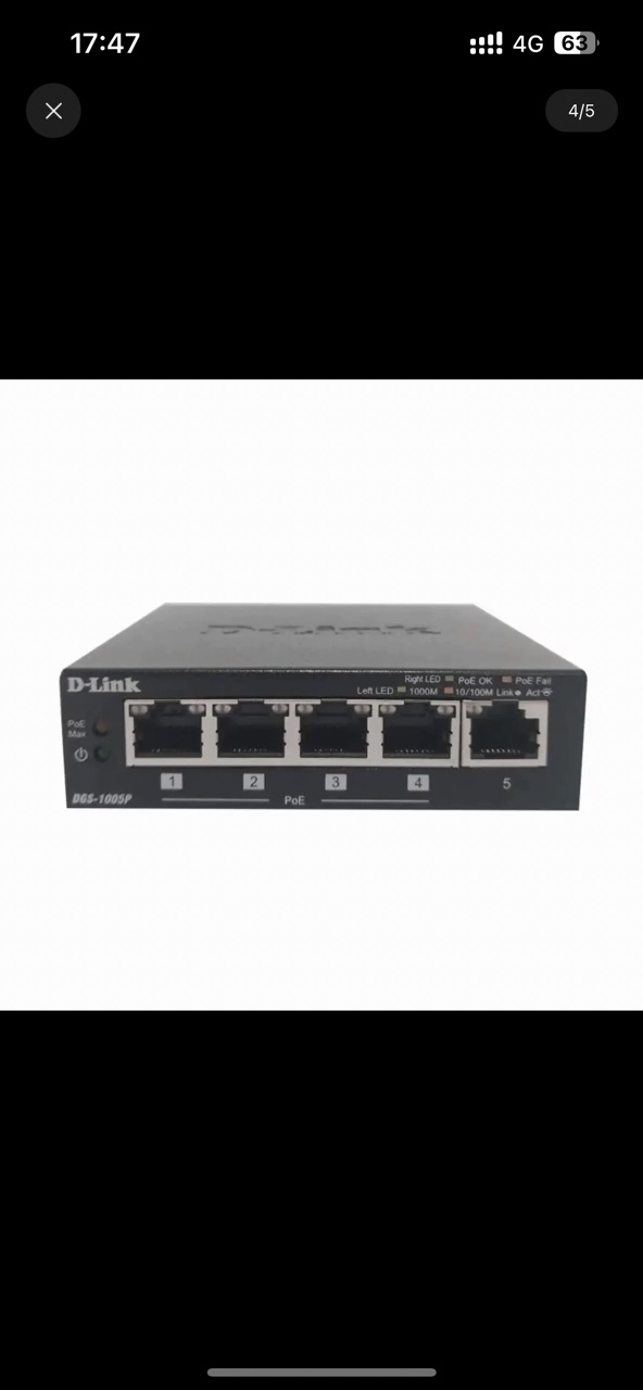

we buy a Dlink and test it out
Is this it?
The Dlink switch I just tried is a DGS-1005D like this one https://www.ldlc.com/fiche/PB00021131.html
