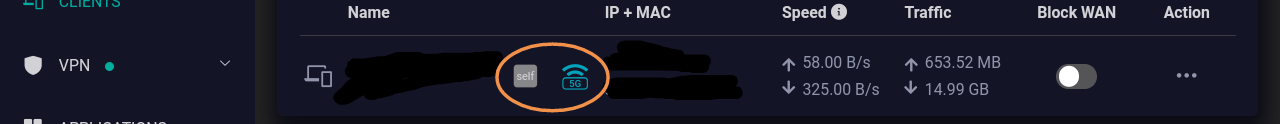

This is what the set up looks like to me, I was told that the ISP router can transfer data to the Flint faster in router mode via ethernet than in repeater mode from ISP router wifi to Flint wifi so that is what I went with. I’ve no idea about Link Aggregation but I’ll look into it as a potential benefit.

In the Admin Panel screenshot, it appears the client device is connected to the GL-AX1800 over 2.4GHz WLAN. It does not appear that 5GHz WLAN is enabled. Can you confirm?

I am definitely connected through 5G wifi, the 2.4G wifi is a guest network for other devices. Unfortunately I can’t do a pure ethernet test as I only have a tablet and no ethernet compatible device.
