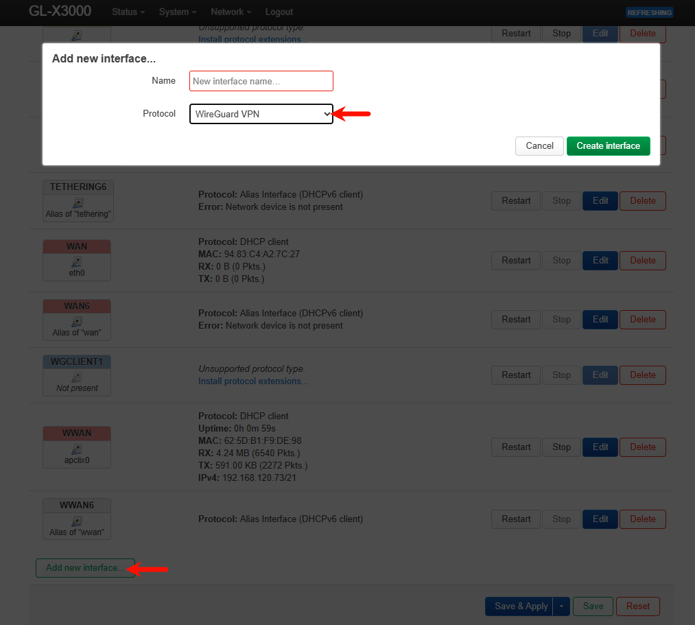

X3000/XE3000 can also be configured in Luci, please use router SSH:
Install the Wireguard protocol
opkg update
opkg install luci-proto-wireguard
If your X3000/XE3000 is in v4.8.x firmware, also need to execute:
uci set route_policy.global.enabled="0"
uci commit route_policy
rtp2.sh
You can find WireGuard in Luci:

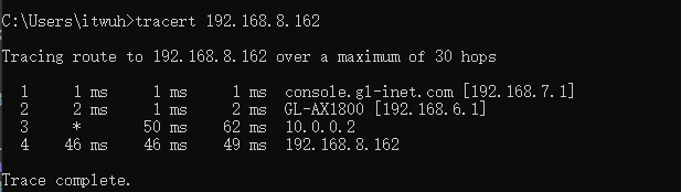

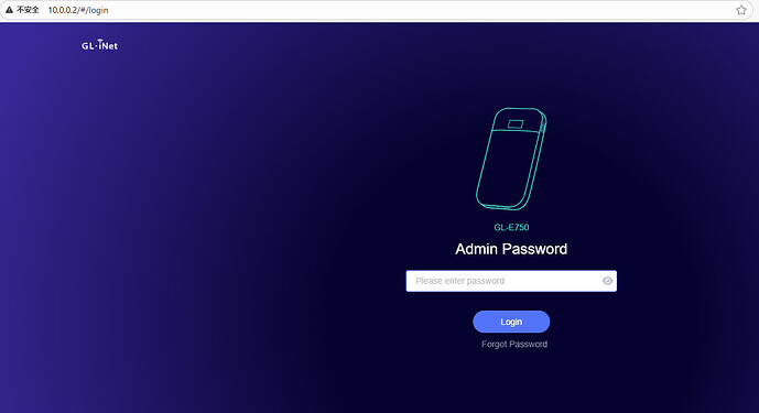

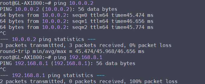

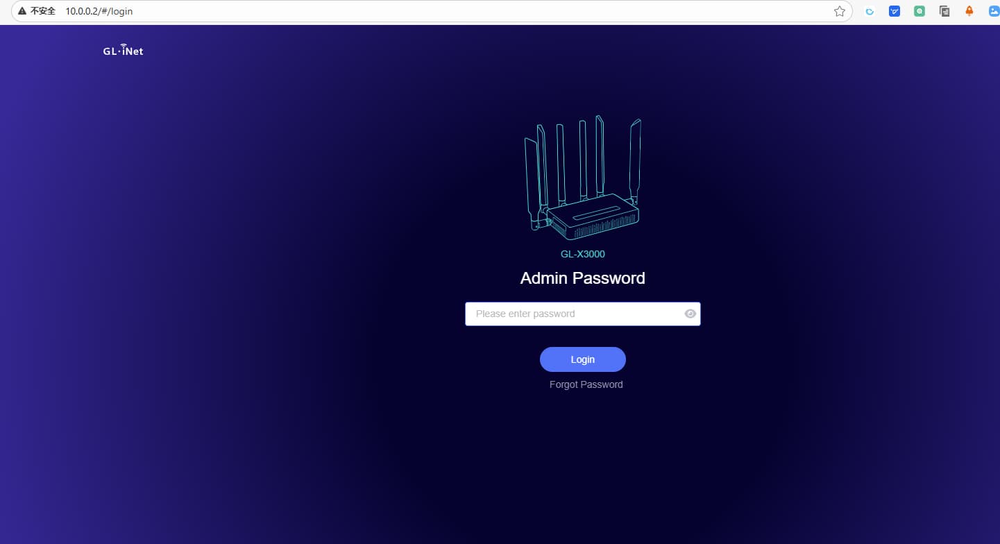

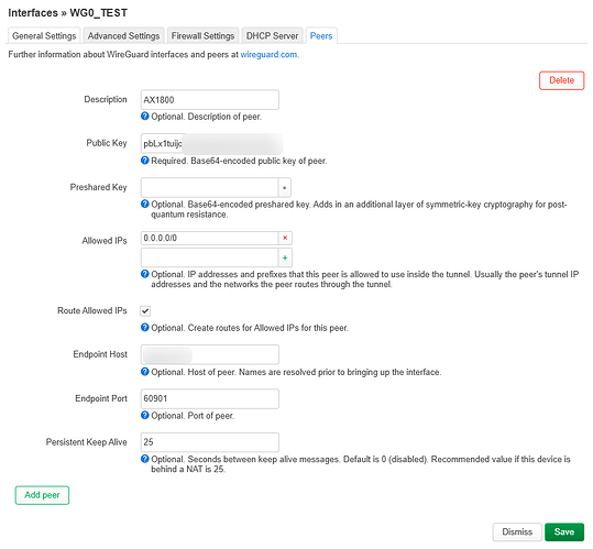

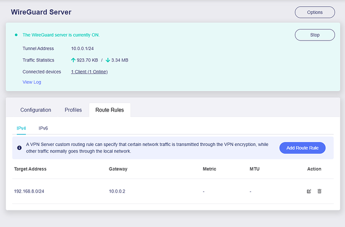

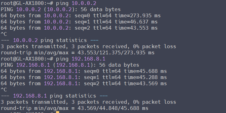

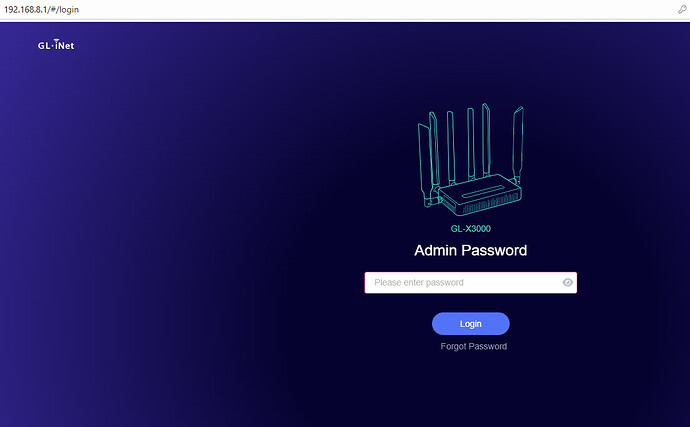

I tested the E750 and X3000 as WG clients locally, with the AX1800 as the WG server.
The parameters for the AX1800 WG server remained unchanged, while the E750 and X3000 used the same profile.
When testing the WG client in E750 and X3000, the WG interface only enable one of them, other one would disconnect.

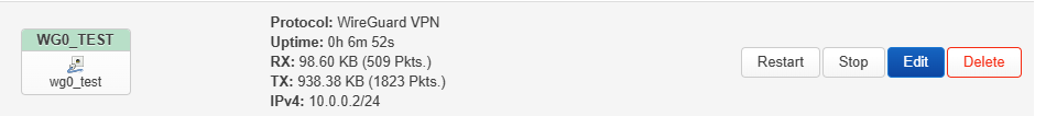

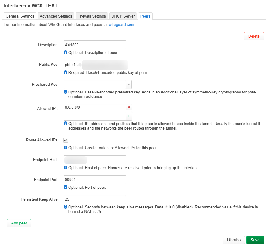

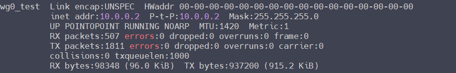

For the E750 and X3000, I manually created and configured the wg0_test interface in Luci and set up a wg0 firewall zone.
Bruce_2025-10-11_19-07-24
Both behave the same:

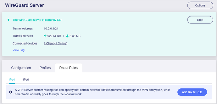

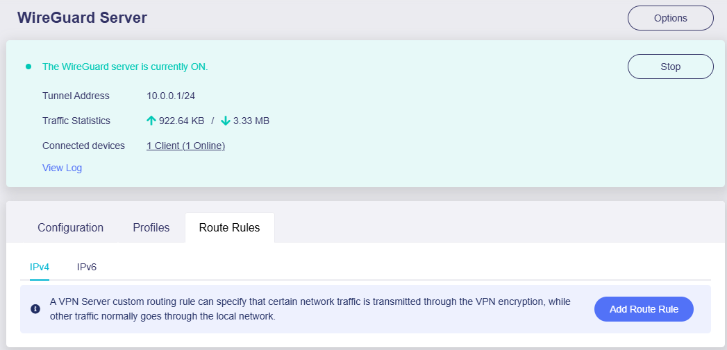

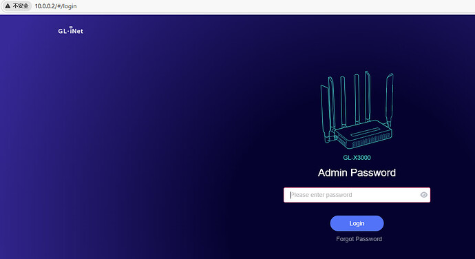

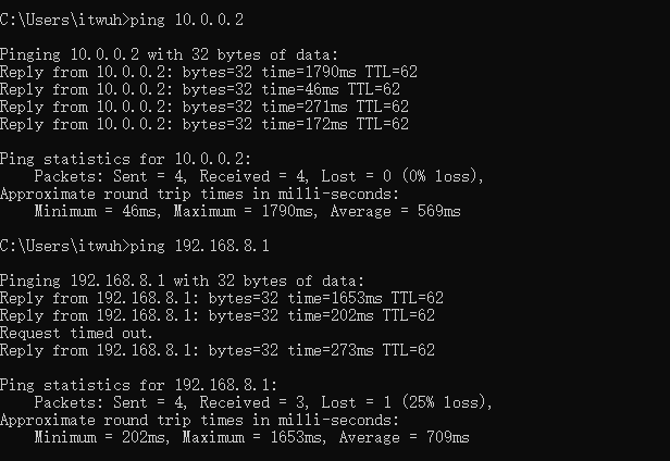

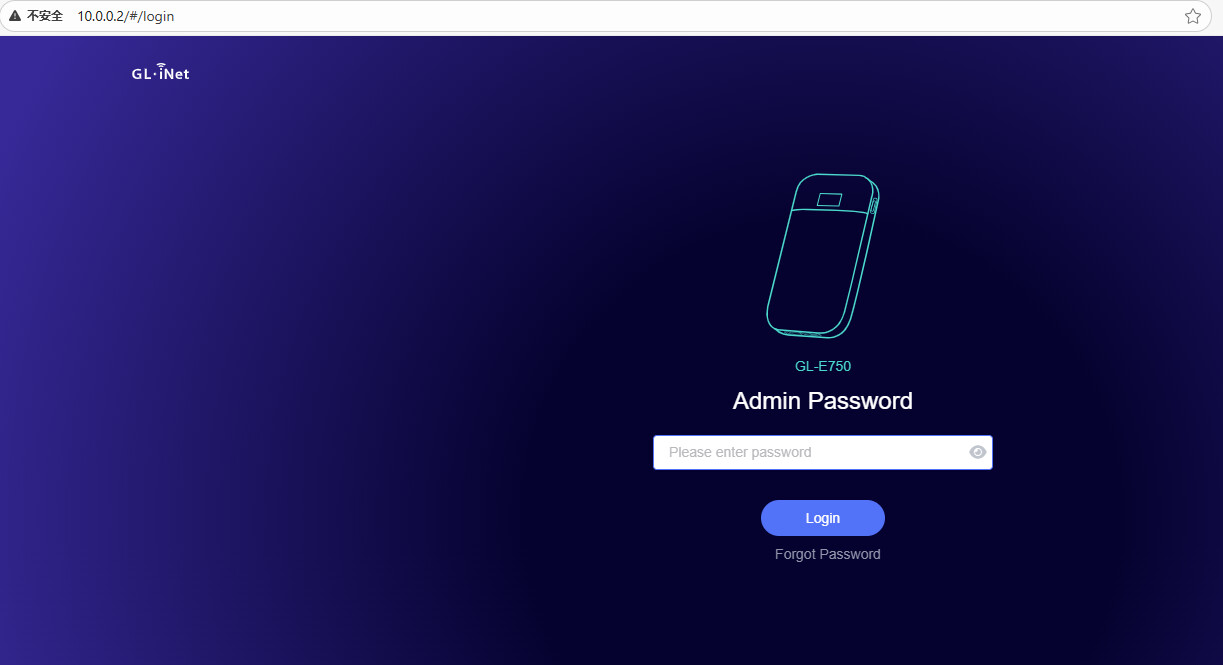

  1. When no route is added to the AX1800 WG server, the PC in AX1800 LAN can only access the GL GUI through the WG tunnel IP of the E750 or X3000, but cannot access the GL GUI through the LAN IP of the E750 or X3000.
    AX1800 WG server (no route):
    PC in AX1800:
    AX1800 SSH terminal:

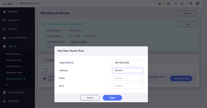

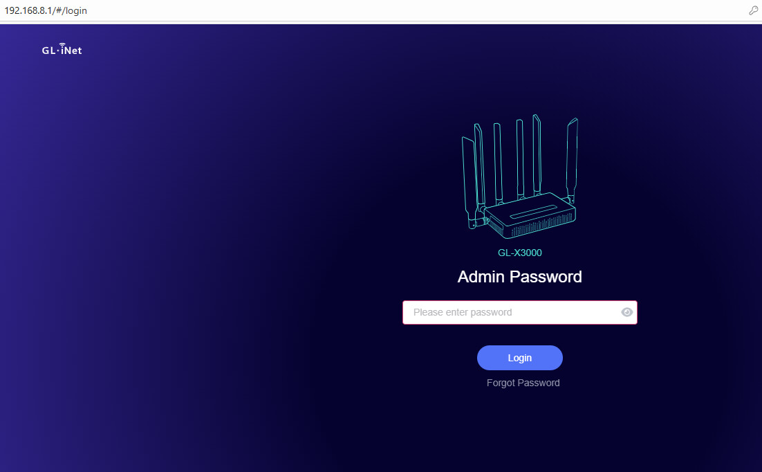

  2. When added a route to the AX1800 WG server, the PC under the AX1800 can access the GL GUI through the WG tunnel IP and LAN IP of the E750 or X3000. This also means that the LAN clients of the E750 or X3000 can also be accessed.
    AX1800 WG server (add route)
    PC in AX1800:
I think they are the normal expectation.

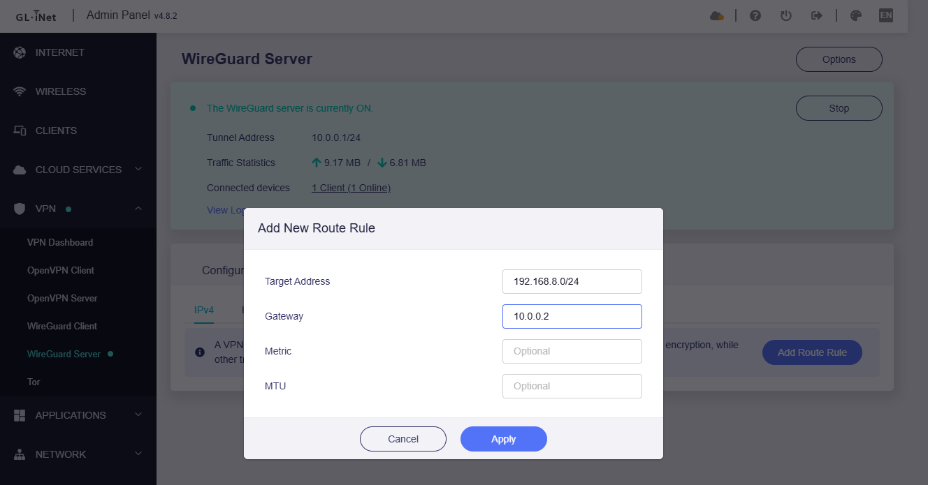

Oh, I know what is going on. Another (very hidden) reproduced condition is that the server zone/interface of firewall in the VPN server router does not enable IP masquerade.
Yep, this is an issue actually with the VPN client, and this issue will be fixed in the future firmware.
With this current firmware, you can add a static route on the VPN client router, so that server requests with the router LAN IP can be reply through the wgclient interface:
ip r add [VPN server router LAN subnet] via [VPN client WG tunnel IP] dev [WG client ifname]
# For example, my VPN server router (AX1800) LAN subnet is "192.168.6.0/24"
# VPN client (X3000 or E750) WG tunnel IP is "10.0.0.2"
# WG client interface name is "wgclient1"
ip r add 192.168.6.0/24 via 10.0.0.2 dev wgclient1

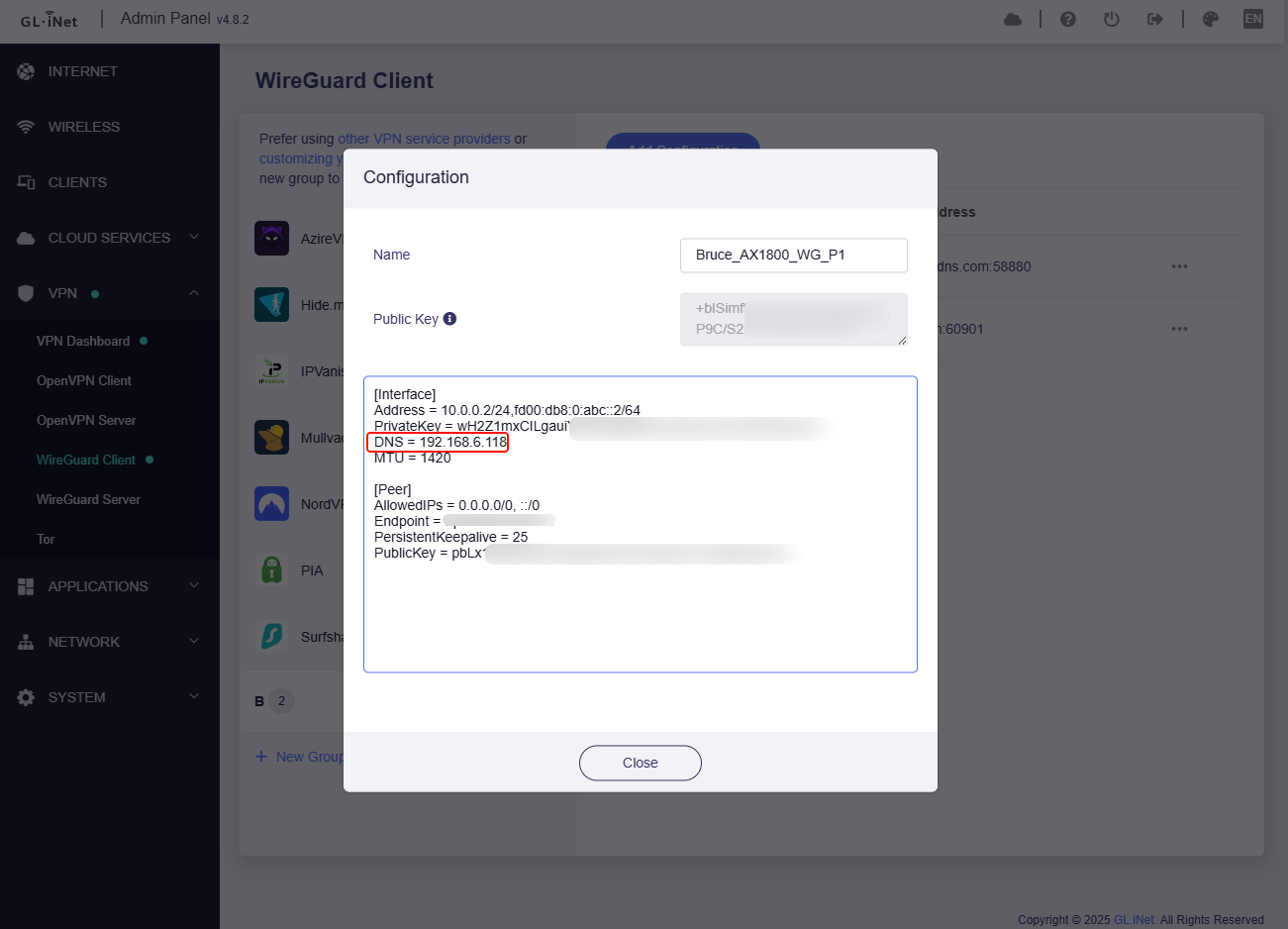

Thanks for the updates.

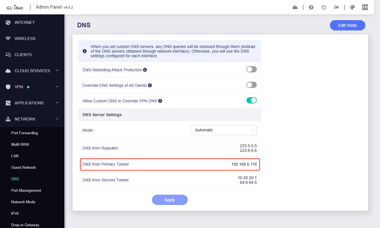

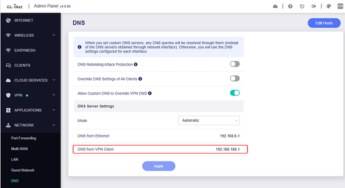

If you want to use VPN DNS, just modify DNS = to VPN server IP or DNS server IP in the VPN profile, and DNS mode select Auto:
Follow above settings, after the VPN client is enabled, all DNS requests of LAN clients will go through the VPN tunnel and to the VPN server.

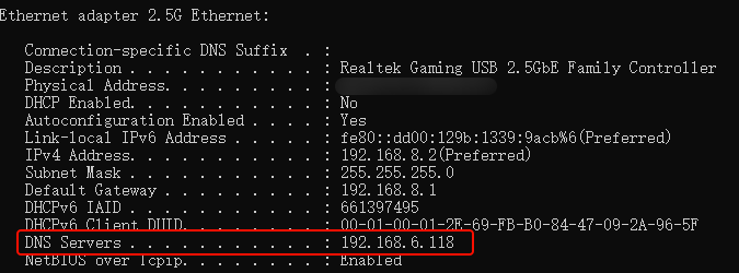

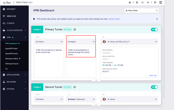

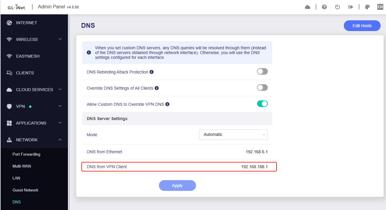

After watching your video, I set up a test environment similar to yours and try to reproduce it in locally. No issues were found.
I'm not sure if there are differences with your environment. For example, if Win is the DNS server obtained via DHCP by default, the DNS server displayed when CMD enters nslookup should be the router LAN IP (like GL router default LAN IP, 192.168.8.1). However, when CMD nslookup is displayed in your video, the DNS server is a specified one. I guess you have manually customized the DNS server on the network card of Win.

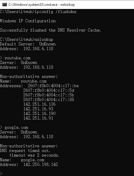

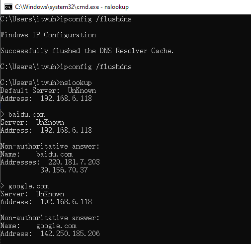

My test process and results are as shown in the screenshot below:

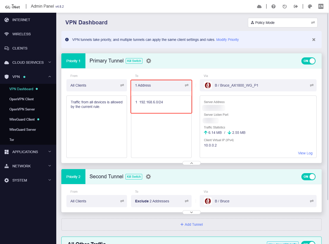

  1. The VPN tunnel did not configure any policy:
    Win CMD, DNS works properly:
  2. The tunnel configured a include policy which only the AX1800 LAN subnet (including pihole IP):

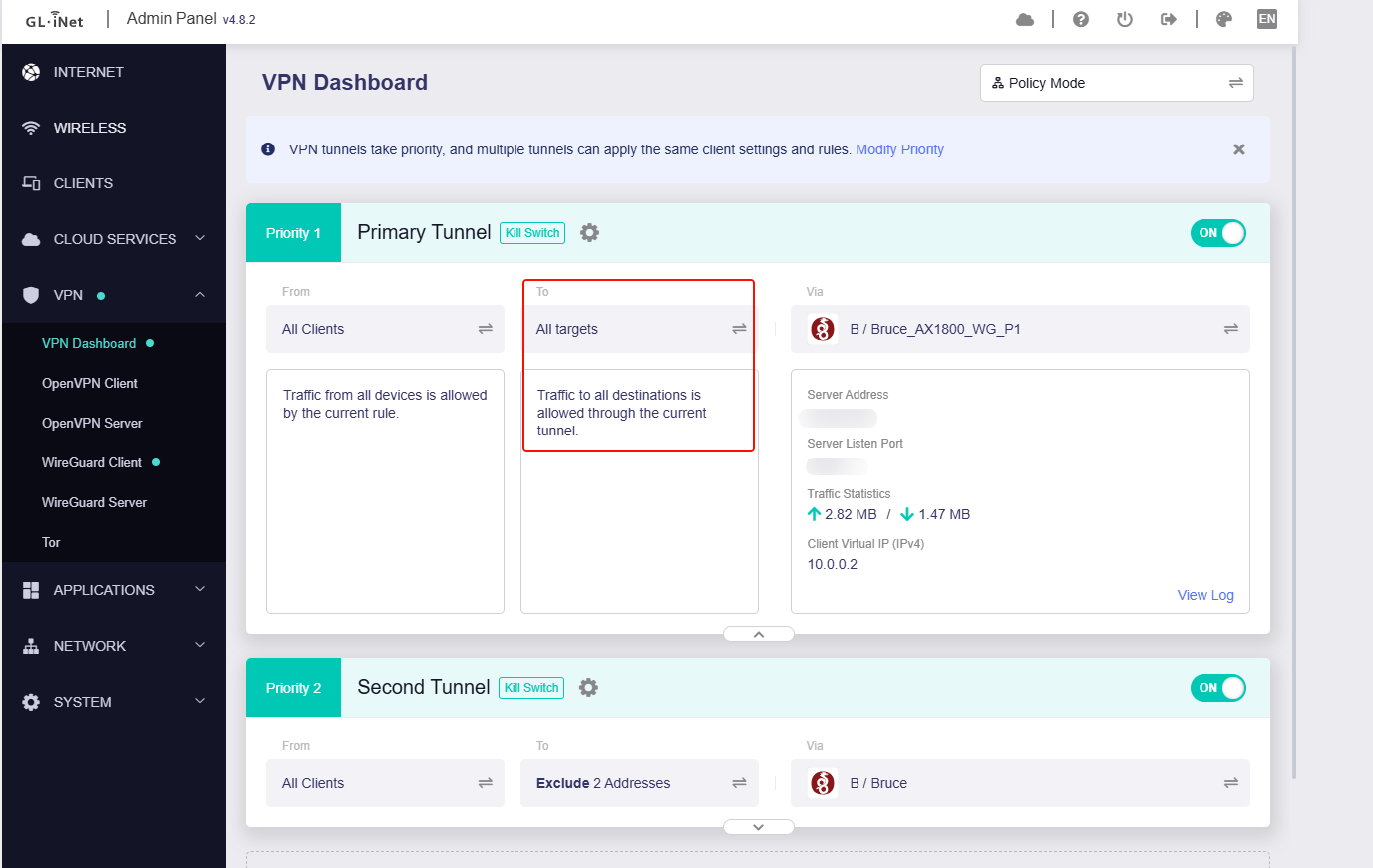

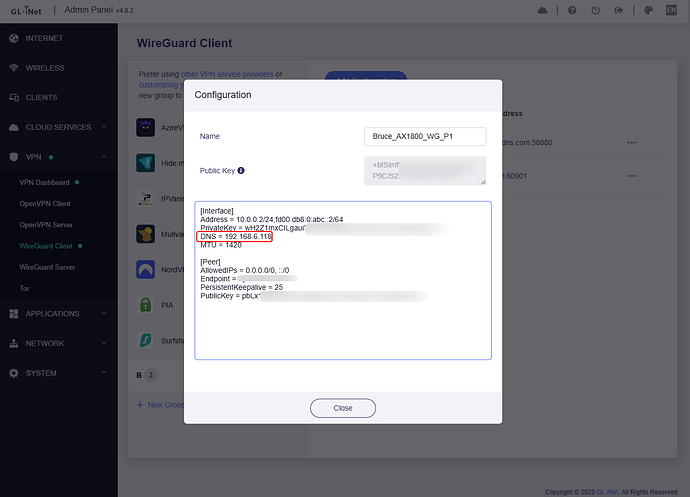

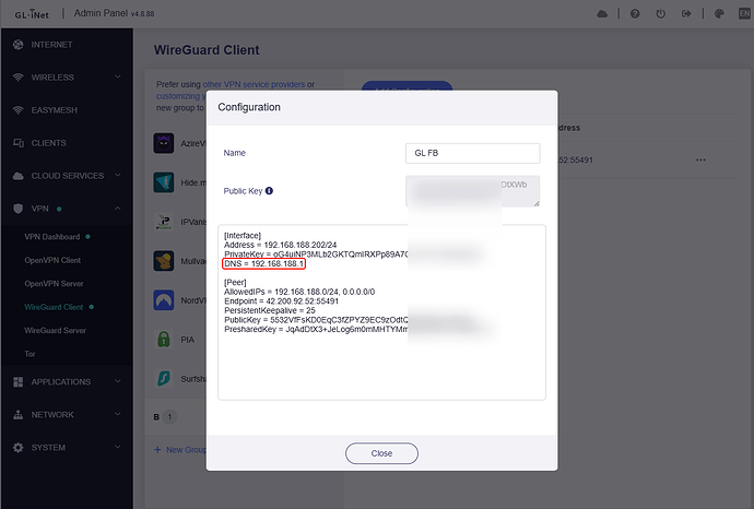

  1. From your video, I saw that in your VPN profile, AllowedIPs has designated routes.
    Please change to AllowedIPs = 0.0.0.0/0, ::/0 and test again.
  2. From your video, I saw that in X3000 tunnel options, IP Masquerading is disabled, please try to enable it. (But I tested in locally, whether the IP Masquerading disabled or enabled, both DNS works properly.
If no luck, please share your router with me again.
