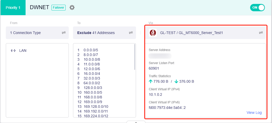

Why not try to establish VPN tunnels in GL GUI?
The firmware v4.8 of X3000 has supported multiple VPN tunnel and tunnels Failover.

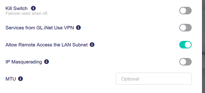

If the GUI would allow setting things like “this WireGuard network has no access to local LAN,” that would be really cool. :blush:

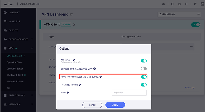

Yes, please try that in X3000 with v4.8.firmware.

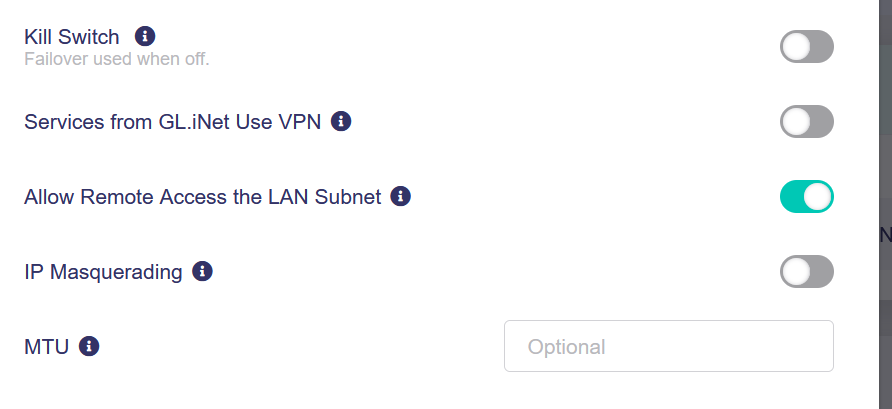

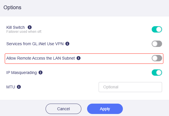

If Allow Remote Access the LAN Subnet is not enabled, the LAN subnet of this router cannot be accessed.

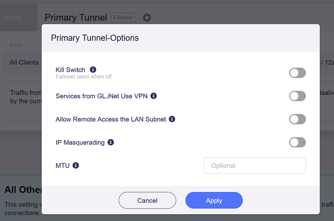

I’ve managed to get the VPN up and running so far. The first tunnel is established, and I can successfully ping the remote side. I disabled Global Mode so that only specific traffic goes through the tunnel as intended.
When the tunnel is off, I can access the internet without any issues.
However, when the tunnel is active, I can only reach the remote endpoint, but I lose internet access.
I’ve disabled all options that should prevent this from happening – Global Mode is off.
What am I doing wrong?

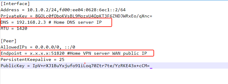

[Interface]
Address = 10.xx.xx.200/24
ListenPort = 13231
PrivateKey = deleted
MTU = 1420
[Peer]
AllowedIPs = 10.aa.dd.1/32, 10.12.yr.0/24, 10.xx.xy.0/24
Endpoint = 80.tt.uu.7:13231
PersistentKeepalive = 25
PublicKey = deleted

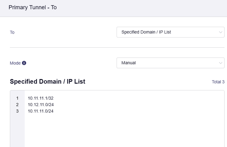

Try changing your profile AllowIPs to "0.0.0.0/0", fill in "10.aa.dd.1/32, 10.12.yr.0/24, 10.xx.xy.0/24" into To's Specified Domain/IP List:
In this way, the traffic accessing these IPs or subnets will go to the VPN tunnel, and other Internet traffic will go to the WAN.
Configuration according to your needs, for reference only.

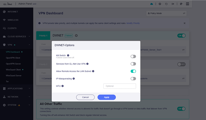

Hello @bruce,

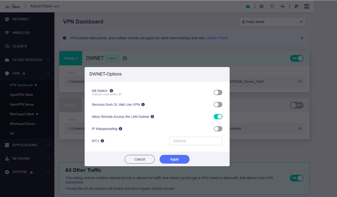

I have been testing the GL.iNet interface for hours now, and I keep running into issues.
Problems:
  • At home (192.168.1.0/24): I cannot access 172.10.10.200 (GL.iNet in the camper).
  • GL.iNet to work: The VPN tunnel does not work. Only one tunnel ever works at a time.
Configuration:
  • Policy Mode enabled
  • 2 WireGuard groups with one connection each
  • Kill Switch on or off inside the tunnel makes no difference
  • "Allow Remote Access to the LAN Subnet" is enabled on both tunnels
The second tunnel I start always stays orange. It never comes up.
I have been testing for hours without success. :frowning:

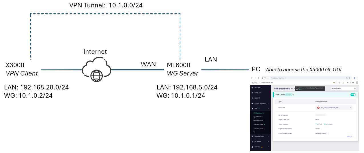

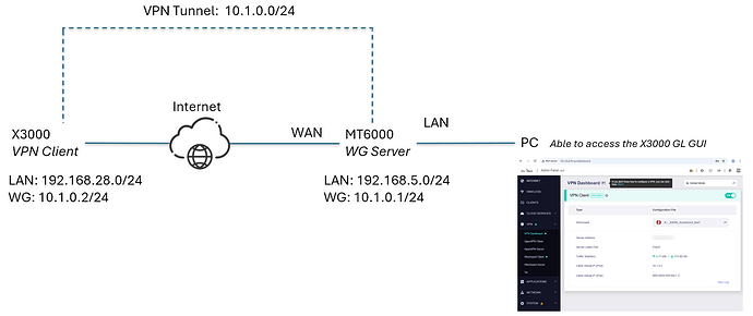

Since I can't reproduce your issue locally, I would like to deep know about your issue and situation.
The PC connected to MT6000's LAN, is not only able to access the remote X3000 (vpn client) GL GUI, and the X3000 LAN clients.
  1. Please provide your network topology, as detailed as possible, including the VPN server router, VPN client router (X3000), their IP subnet, etc.

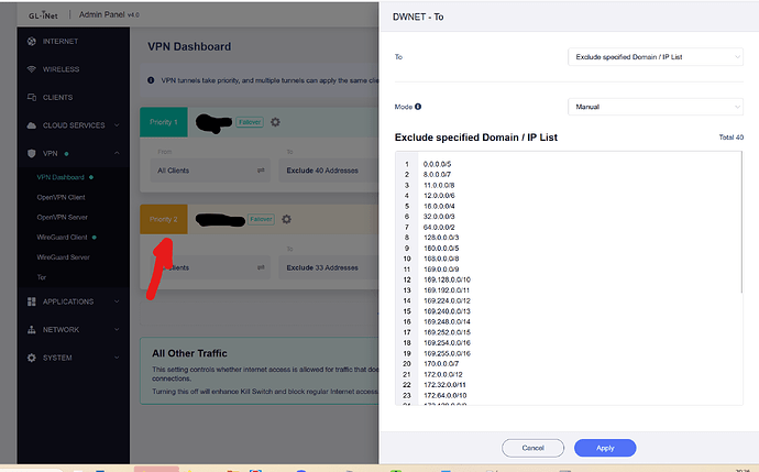

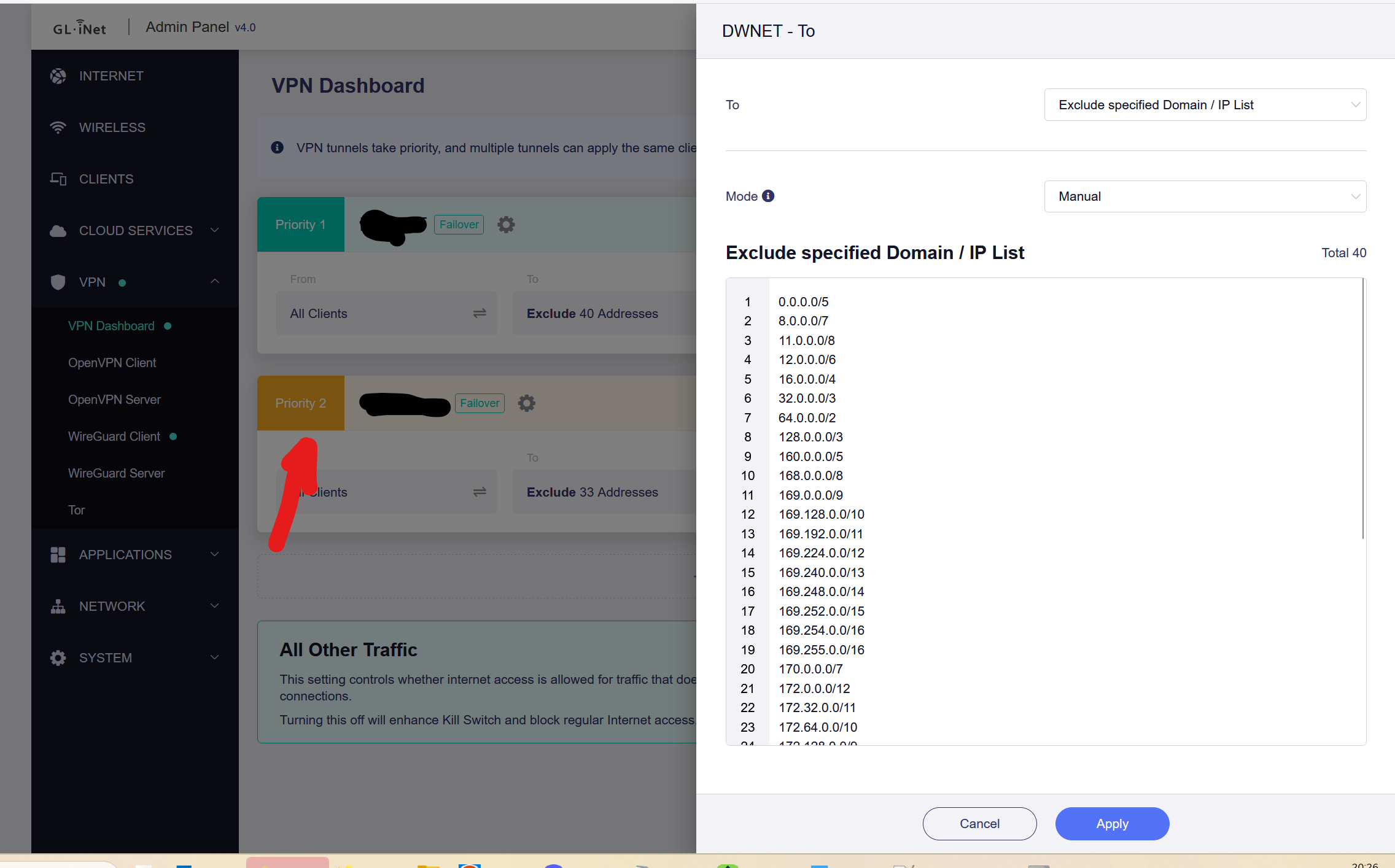

My goal was to use a DNS server on the other side of the VPN tunnel.
(What would be really great is if I could keep the DNS on the X3000 and just use domain-based forwarding — like it's possible in LuCI.)
Initially, I hadn’t entered any domains in the “Domain List” field, so the router silently dropped all UDP DNS packets — only TCP DNS requests were allowed.
When I did enter specific domains, the client was only able to query the DNS server for those exact domains. That would mean I’d need to list every domain in the world — obviously not practical.

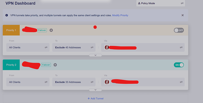

The alternative is to use the Exclude Mode under VPN Policy Routing, and invert the logic.
So instead of defining which traffic should go through the tunnel, I excluded all global IP ranges except my internal networks (the ones I want to route through the VPN).
This way, the DNS server — and any other internal services — are reachable via tunnel, and all other traffic goes out via regular WAN.
I think this behavior should really be made more clear in the UI or documentation — maybe a warning or help icon could explain it better.

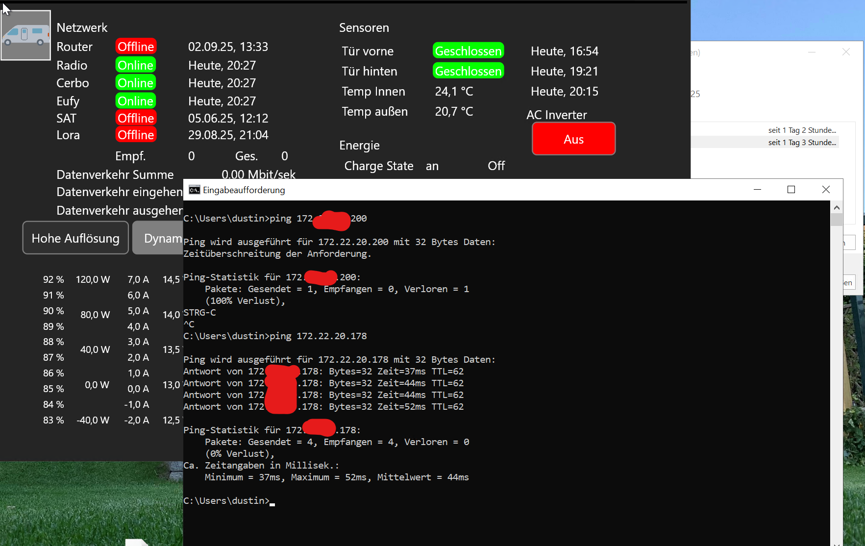

Now I still have two remaining issues:

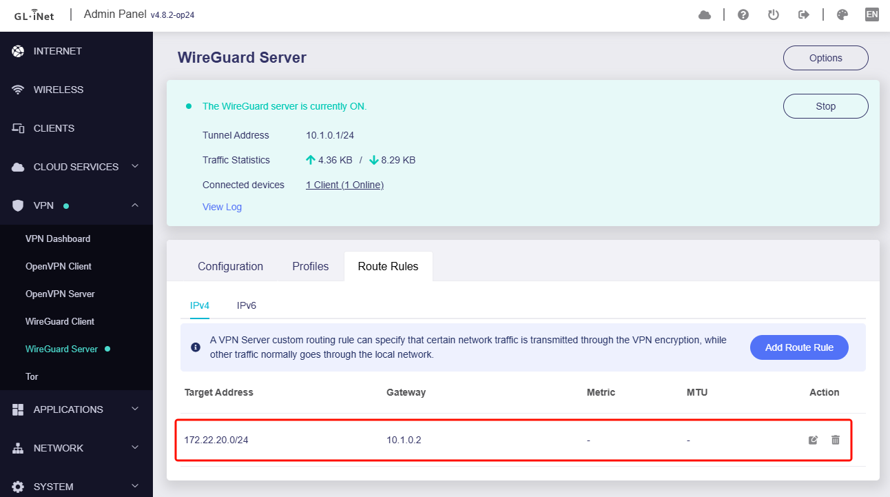

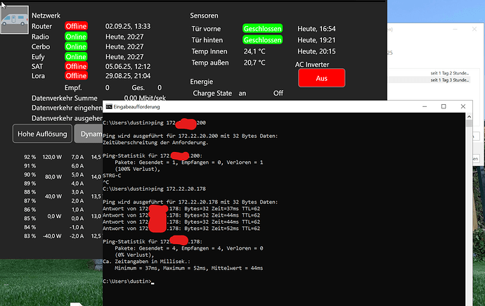

  1. No ping from home to the camper router — everything else is reachable (servers behind it, DNS, etc.), but not the router itself.
  2. Only one tunnel can be active at a time — even though both are defined.

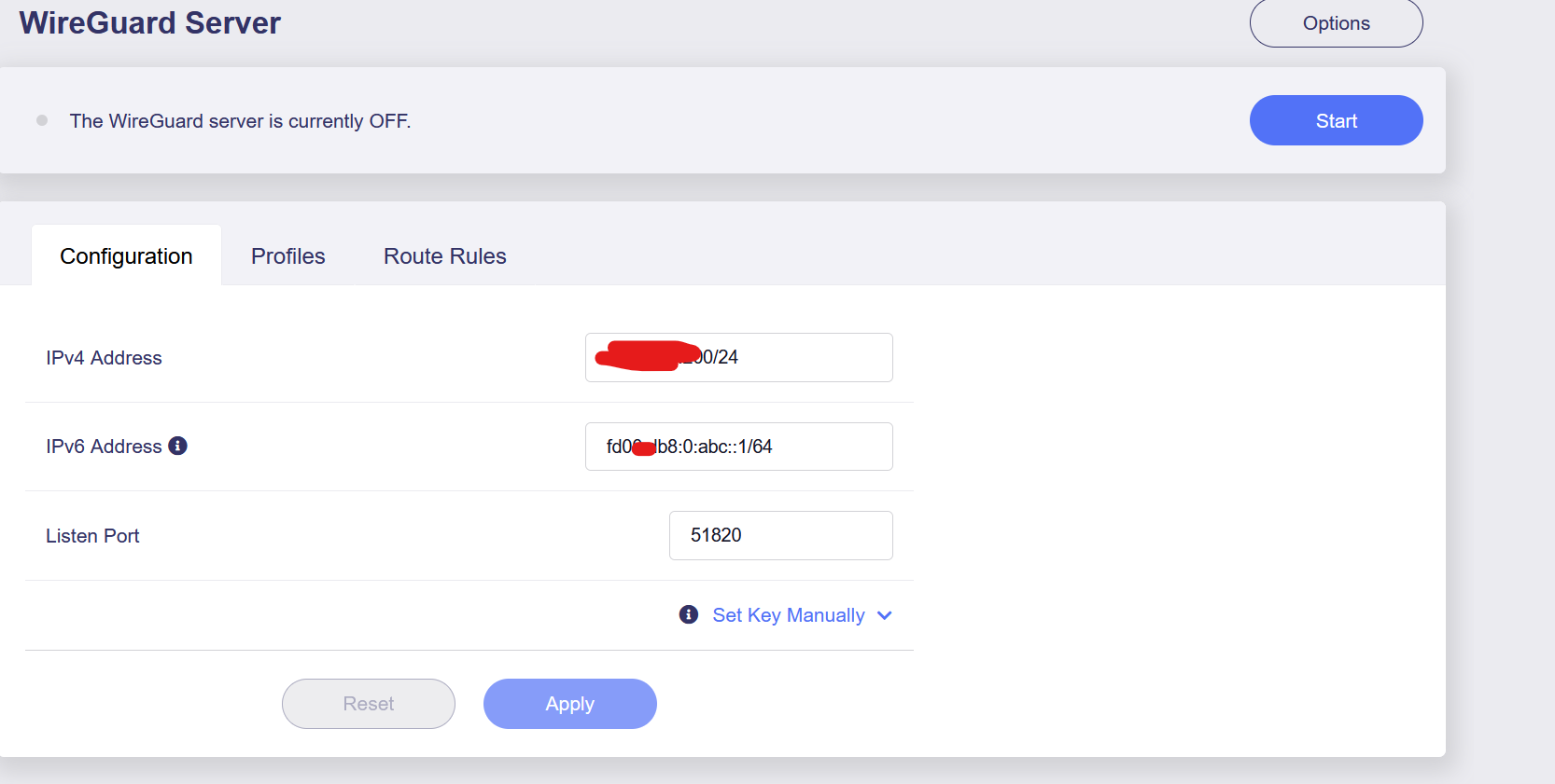

This is at Home:
200 is my X3000 Spitz
178 is my Victron Cerbo
Radio, Eufy is also online!
Tunnel Chance, the other one is online:
Are these two tunnels not connected to the same VPN server, right?
I will check DNS in the remote.
In addition to DNS server, I will also check:
  1. Tunnel 2 connection status
    2. Please tell me what rules do you need to do? To ensure that the tunnel connection is normal, we first set Profile AllowedIPs to 0.0.0.0/0, and then fill in the IP you need to go to VPN access in To - Specified Domain / IP List.
  2. Ping from home router to X3000 - Please enable Allow Remote Access the LAN Subnet on X3000, and access the GL GUI via the X3000 VPN tunnel IP, like 10.1.0.2
  3. Do not configure anything in Luci. If you have configured it in Luci, please restore the device to the factory first, then import the VPN Profile, and then share it with us with GoodCloud.

It’s clear that “Remote Access the LAN subnet” has to be enabled, we already discussed that. If it were off, I wouldn’t be able to reach anything. But I am polling the Cerbo from Victron every second via Modbus.
IP masquerading must of course be disabled, but in your screenshot it is enabled.
As I already mentioned, I completely reset the router yesterday and configured everything, including enabling LuCI. And the router behaved exactly the same as before I reset it. I only enabled LuCI afterwards so I could make a backup, nothing more.
PS.
This “hack” I built with the exclude for VPN is hopefully not supposed to be a permanent solution.
You should create a static route in your VPN server.
Test with my MT6000 VPN server as follows, when I created a static route in MT6000, the ping of MT6000 is able to receive the reply from your X3000 LAN clients.
The test process:
  1. Switch to my test profile on your X3000. (The test profile from my MT6000 VPN server. Deleted after the test, and restored to your own two profiles)
  2. Keep your original tunnel options:
  3. My MT6000 VPN server, created a static route:
On MT6000 SSH, ping your X3000 and X3000 LAN clients:

The ping without issue, indicating that there is no problem with the X3000 VPN features.
Hello Bruce,
thanks again for testing. When I power down my X3000 and bring up the old Mikrotik, I can reach the Mikrotik without any issues – and I don’t need to change anything on the remote peers.
From your test, I suspect that the X3000 is still routing some network that I’m not aware of. When I try to reach the router, it might be using an additional network or IP address on the WireGuard interface to send the return packets. In that case, I wouldn’t get any reply, because my home peer doesn’t know that network. However, in the GL.iNet UI I don’t see any extra networks configured.

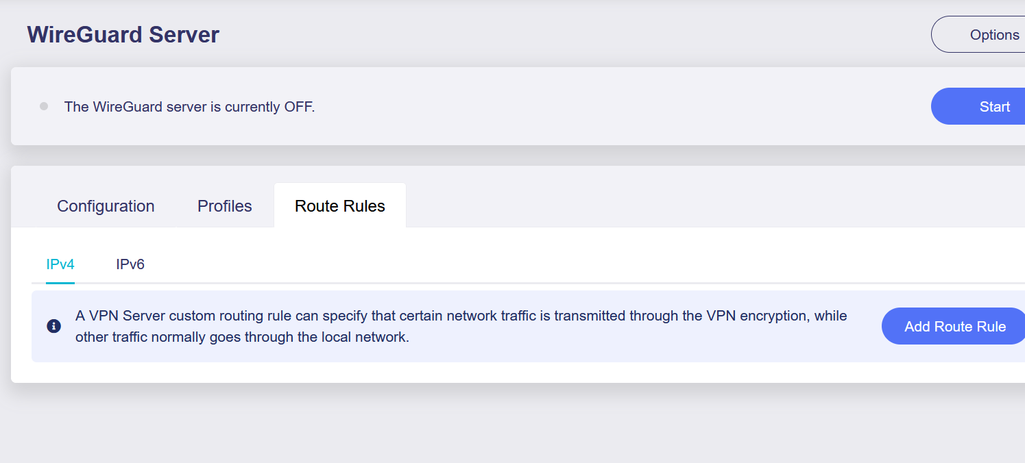

The WireGuard server is not enabled on my GL.iNet device.
Also, when I check via SSH, I don’t find any unknown IP addresses.
Could this be the issue?
