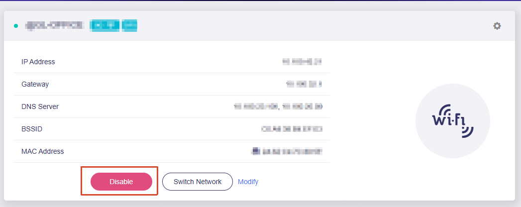

This seems a little unusual, as the Admin Panel already includes the relevant button and description. Are you using the Repeater feature through another interface, such as LuCI or SSH?
If so, and you do not plan to use the Repeater feature in the Admin Panel, you can disable the repeater service to prevent it from interfering:
/etc/init.d/repeater stop
/etc/init.d/repeater disable

You're right that the Admin Panel shows "Repeater (STA) is disabled" with
a Connect button. I was wrong in my earlier post to say it doesn't. The
problem is that the router ends up in that state by itself after a power
cycle, without anyone pressing Disconnect.
