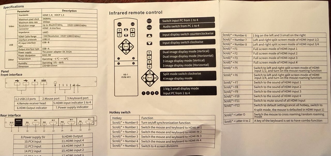

I have NOT had luck with Amazon.com: 4x1 HDMI KVM Switch w/Multi-Viewer, 4K 60Hz Quad HDMI Screen Divider Switcher, 4 in 1 Out Seamless Switching with 4xUSB A 3.0 Cables, Quick View for Camera, PC, Laptop, Fire Stick, Roku : Electronics and have a pending topic awaiting approval on the steps I’ve attempted with this device. Here are the bizarre instructions. I can setup hotkeys but cannot get the mouse to work even after disabling usb storage and changing keyboard type.
Do the shortcuts work if you setup a shortcut to do ctrl-ctrl-#-enter? I can’t seem to get this to work, but it does work if I bring up a virtual keyboard and do it.
Benefits over this KVM vs the other KVM I was trying in the post above, this one lets you change channels even if signal isn’t detected (so that you can wake a system up). I could not do this with the other one.
I currently don't have access to that model, but IIRC it behaved as my current one does - try omitting the . Note that you may not be able to use the Comet Hotkey feature for this, it seems to be sending simultaneous keys instead of a sequence separated by time.
