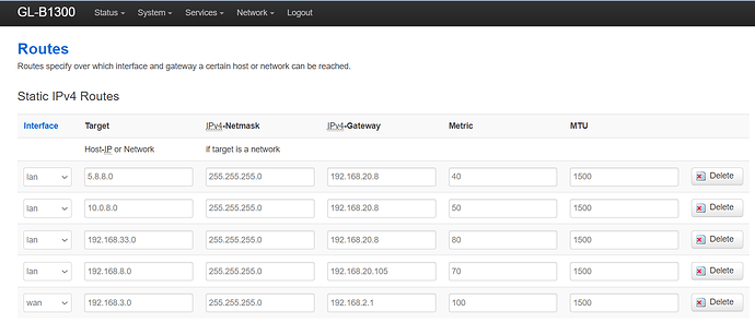

I just find another post for a similar issue (see here: WAN gateway incorrect / not updating in WISP mode - Technical Support for Routers - GL.iNet (gl-inet.com) ), and I applied a similar correction by removing a static route towards the subnet 192.168.3.0, and the wrong information of the Internet Gateway appears to be fixed. The issue in my case (with respect to the above-mentioned post) is that I need the static route on the WAN interface towards the subnet 192.168.3.0/24. So, the question is: how could I configure the needed static route for the WAN interface, without affecting the Gateway shown in the Wired Internet WAN page?
Can you let me know how you configured the static route? This needs to be fixed anyway.
As soon as I add the static route at the bottom (the one related to the wan interface):
the following is the effect for the WAN Interface:
As soon as I delete such static route:
the WAN Interface gets back to the correct values:
I hope this helps to fix the issue.
