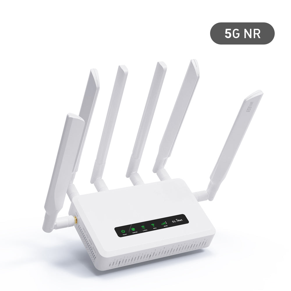

Hello, I need a USB 12 volt power cable for use in a motorhome, for my X3000, can anyone recommend one? I have one here on my old x750v2 but the cable doesn’t work properly!

Its just a 5.5mm x 2.1mm barel adapter. The X3000 can accept a wide range of input voltages from 9v-36v so you can connect it to your RV’s 12v power supply.
I use this one for my X3000 in my travel trailer (no, I don’t use the included adapters), but anything similar with a 5.5x2.1 barrel adapter will work: https://www.amazon.ca/gp/aw/d/B0925ZX7V3

The Spitz AX is spec’d to use a maximum of 12 volts at 5 4 amps (60 30 watts).
A standard USB plug is 5 volts at 0.8 amps (4 watts), although most today (and what I’d expect to see installed in your camper) are 5 volts at 2.1 amps (10.5 watts). Unfortunately, even with an adapter with a step-up converter, you’re still restricted by that total wattage - which means that at 12 volts, the maxumum you could get out of a 10.5 watt USB plug is 0.875 volts (not accounting for loss, which will be an additional 10-15%), which isn’t enough to power the X3000. I’m sorry, but you’re not going to be able to power the X3000 from a USB outlet in your trailer.
You’re going to have to run a 12 volt line to your X3000. You may have to run a new line from your converter/12v-fusebox, or possibly be able to tie into a existing line (e.g. for 12v lights, or even the line going to your USB outlets) if it can supply the additional 5 2.5 amps.

-EDIT- According to the spec sheet. the X3000 pulls 2.5A at 12v. I had taken the 5A from the supplied charger. Although this halves the max wattage required by the router, its still far greater than a standard USB outlet can supply.
