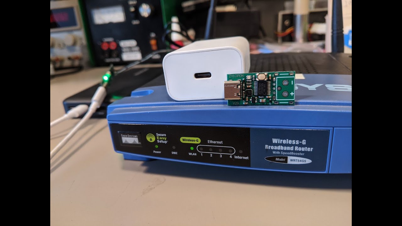

Hmm… It’s not going to be really pretty from a user end perspective, but you could use a USB C decoy trigger set at 12v output and a 4.0mm x 1.7mm to bare wire cable. I’ve included some links below. The trigger assembly can put out a number of voltages, you would need to set it to use 12v as it’s default, and maybe disable the button afterwards to prevent inadvertent tampering. I can’t imagine that the router would support 20v without burning up?
Using this USB C solution, you would not have any risk of brownout/low power because the supply can provide plenty to the router. Just check your voltages before plugging anything in to the router!
One more item… how to use the ZY12PDN decoy adapter.
It’s smarter to use the fixed voltage one, it’s smaller too:
I have used dozens of those from Aliexpress, from the Witrn brand.
Here is something similar, i use it for my laptop:
This is the exact one i use:
https://www.aliexpress.com/item/4000124529027.html
