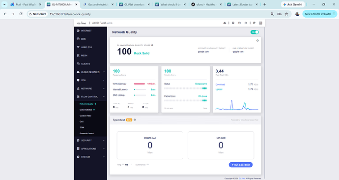

just upgraded my flint 2 to firmware 4.11.0, any idea why my wan gateway is 1000ms? is it a bug?
A fixed 1000 ms reading may represent a probe timeout or capped value rather than the gateway’s actual latency, so the screenshot alone does not confirm a firmware bug. Firmware 4.11.0 for Flint 2 is currently beta.
Please SSH into the router and compare these tests:
GW=$(ip route show default | awk '/default/{print $3; exit}')
ping -c 10 "$GW"
ping -c 10 1.1.1.1
If both show normal latency while Network Quality remains at 1000 ms, that points to a Network Quality display/probe issue; please post the exact 4.11.0 build date and these results in the SDK v4.11 beta thread. If only the gateway test times out, the upstream gateway may be ignoring or deprioritizing ICMP while still forwarding Internet traffic normally.
Thanks for your question.
Could you please check whether the current gateway IP responds to ping and whether its latency exceeds 1,000 ms?
The default timeout for this check is one second. If the gateway does not respond to ping, or if the response takes longer than one second, the interface may display 1,000 ms.
I have the same problem as you. I ran the tests, and the ping responds correctly but exceeds 1000 ms, so the limits need to be reviewed.

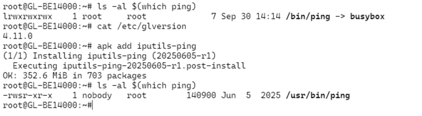

I see exact same behaviours on my FLINT 4 as the other users report.
I had the same issue with 100% loss and 1000ms after a factory reset + restore backup. (was working before)
Then I have tried to ping my wan, which failed:
root@Void:~ # ping -c 1 x.x.x.x
ping: socktype: SOCK_RAW
ping: socket: Operation not permitted
ping: => missing cap_net_raw+p capability or setuid?
ls -la $(which ping)
-rwsr-xr-x 1 nobody root 140900 Jun 5 2025 /usr/bin/ping
So I just changed it to root, which solved the issue for me.
chown root:root $(which ping)
-rwxr-xr-x 1 root root 140900 Jun 5 2025 /usr/bin/pingroot@Void:~ # ping -c 1 x.x.x.x
PING x.x.x.x (x.x.x.x) 56(84) bytes of data.
64 bytes from x.x.x.x: icmp_seq=1 ttl=255 time=3.59 ms
Looks good now.
Hi @Void,
Thank you for sharing your findings.
The stock firmware uses BusyBox ping rather than iputils-ping. Based on the output, it appears that the issue occurred when iputils-ping was installed with incorrect user ID or file ownership settings.
We will ask our R&D team to investigate the package build and installation settings.
