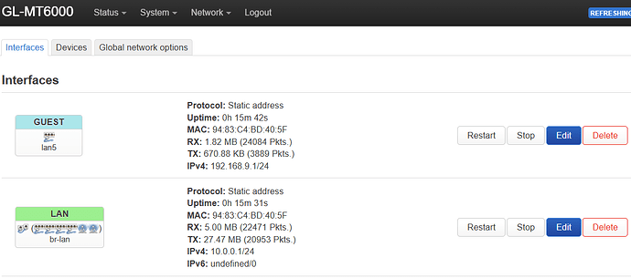

Removed the LAN5 checkbox from the br-lan bridge device.
Edited the Guest Interface and selected LAN5 in the Devices dropdown, then save and apply.
Result: The device on LAN 5 got IP address from the wifi network 192.168.9.x all right, but was not able to ping anything. Weirdly, the guest wifi network also lost internet access for all clients. Then I tremoved LAN5 from Guest interface and guest wifi had internet access again.
This is what it looked like after step 2 (And it took away internet access from all guest network)

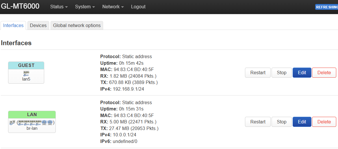

@bruce I have the same settings you have posted except for one big distinction.
Your Guest wifi is not enabled (no IP address), and probably that is why your LAN5 is working fine. My challenge is, I want both the Guest wifi clients and the LAN5 port clients to be enabled together in the same 192.168.9.x network.
Below is what my devices look like, and this configuration does not let LAN5 clients ping anything - in the guest wifi network OR the internet, despite being in the same (bridged) subnet.
However in this case
Guest wifi clients are fine, can ping others and get to internet
LAN5 client cannot ping any other guest wifi clients and cannot get to internet

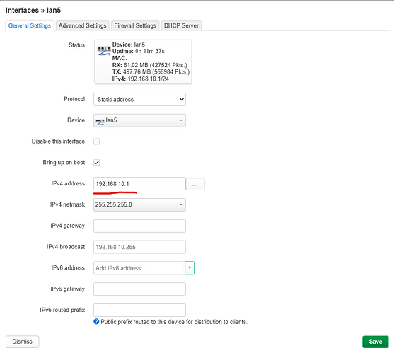

@Void An update, your formula (assigning a different subnet to lan5 interface works.
But as you noted, the lan5 network devices do not appear in the GUI any more. So I’m still hopeful of a solution whereby both guest wifi and lan5 can be in the same subnet.
Sorry that didn’t work, it did for me. Did you remove the LAN5 interface network that you created? If not, then do that.
Also, since you are using the Stable firmware, you could do what I did to create the br-guest device bridge so that you can edit it on that version of the firmware so you can see and edit it in the Advanced LUCI GUI.
