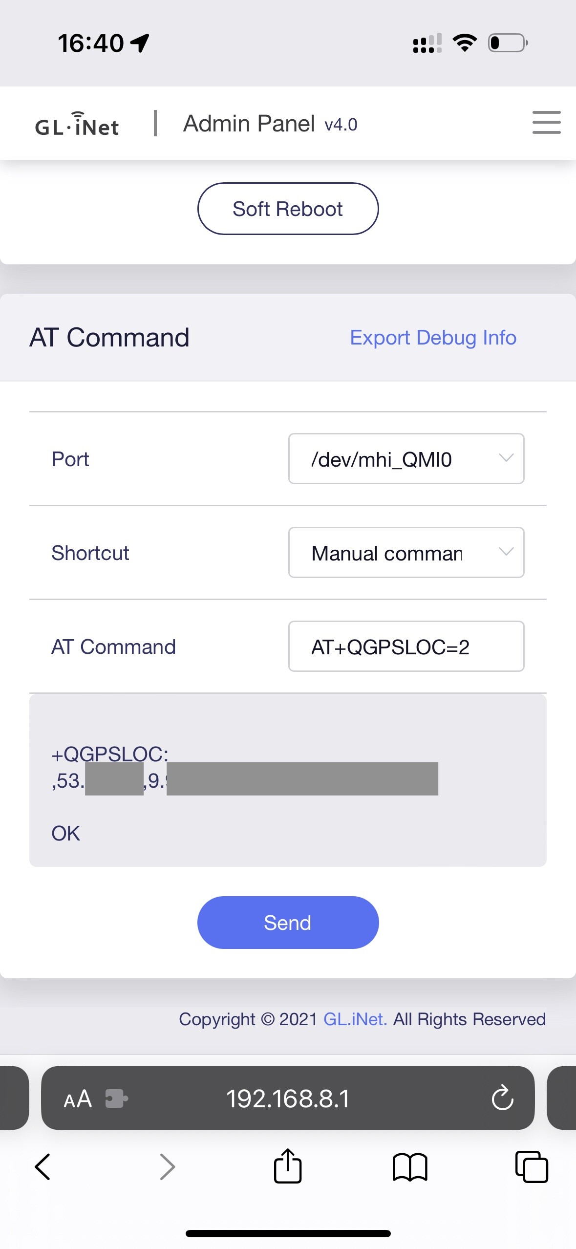

@habeIchVergessen Good news! I was curious and used my 15 minutes of free time today to test the GPS functionality and it works ![]()
Commands used:
AT+QGPS=1 #Enable GPS
AT+QGPSLOC=2 #Get the location information
@nschemel: thx for testing. can you provide the last number of gpsloc string? represents the number of satellites
it’s strange, according to data sheet the antenna doesn’t cover gps frequency.
@habeIchVergessen Here you go. 29 satellites sound a lot. My Victron Cerbo GX, to which I forward the data to, says 9 satellites.
But you’re right regarding the specs the 5G antennas shouldn’t really support the GPS frequencies, but a lot of spectrum below and above that. So obviously it works anyways. But as these antennas are not specialised for GPS frequencies and have a lot lower gain, I suppose the GPS reception is not ideal.
