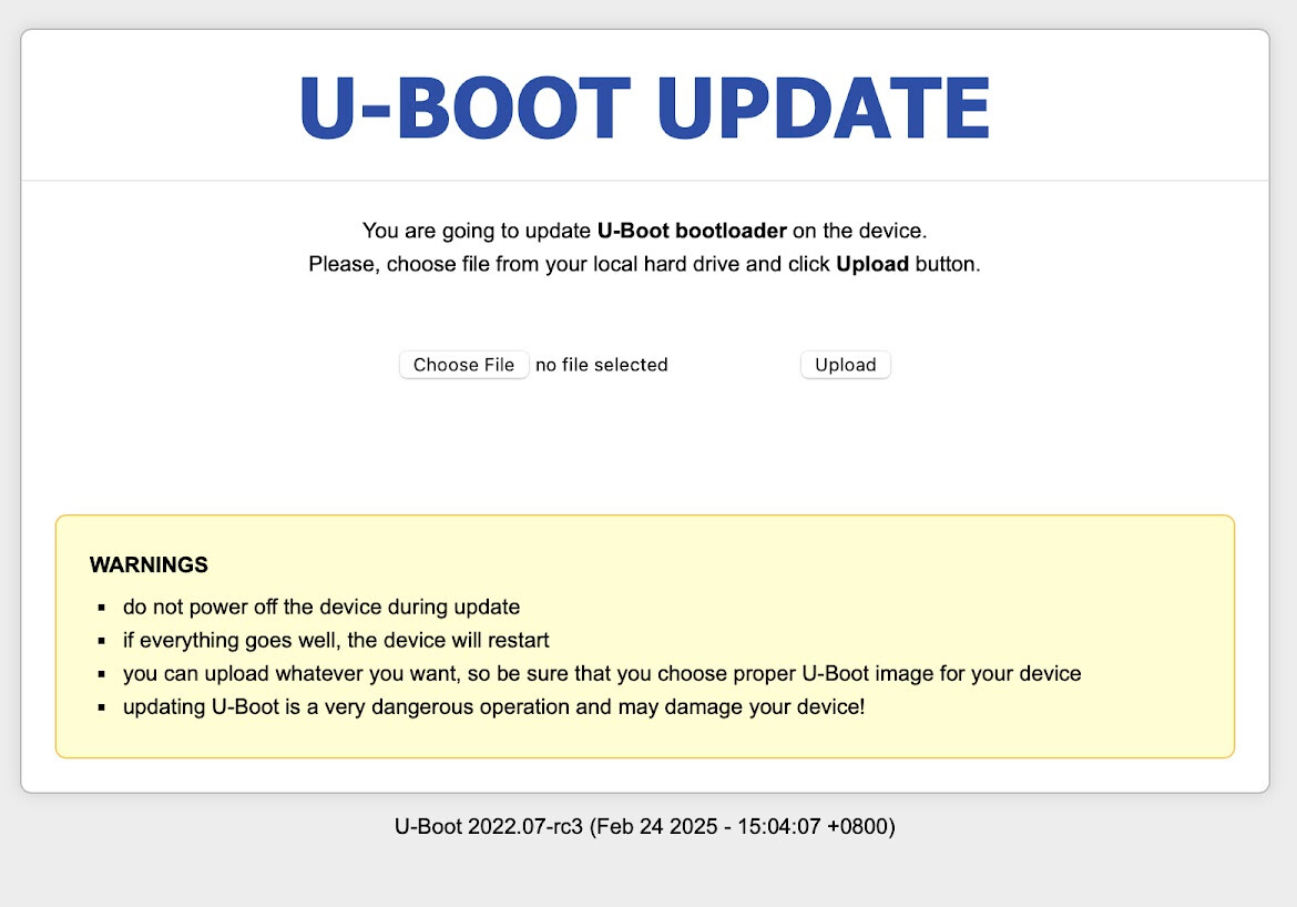

I also used Firefox for the uboot upgrade, and mine bricked. I also had fw 4.7.0 already on the Brume 2 before.
I used Brave browser, but I don't think it is a browser issue everything was as expected but after reboot it died, usually when that happens the u-boot was broken but that is only possible if there are small differences in the emmc chip or maybe the partitioning.
one thing which may be a issue is that after the beta test I did no longer maintain firmware updates, so if there was something like a migration/preparation firmware from longer terms ago, I might had missed that.
did you have fw 4.7.0 before the brick on it? what about others where it worked?
unfortunate I don't know, I just hopped in and tried to go in u-boot directly it could maybe even be below 4.7, before u-boot upgrade it did started normally with leds and I had connectivity.

For those of you who had success, what browser did you use to update the device?
Same question for those who failed to update their device, what browser did you use?
It failed for me in Firefox and Chrome (Chromium)

Just an info for someone that have to try with a Mac.
I tried with an M2 Macbook pro, and with an USB-C/Ethernet adapter and it was impossible to run the procedure.
I needed to use a Windows laptop with integrated Ethernet!

Dear GL-INet or anyone who uses Linux (Mint)
GL-INet Uboot instructions/ X3000
There are no instructions for linux users in the above link that GL-iNet provided.
What are the required settings in the Wired IPV4 for:
Network
Gateway
Are there any other settings that need to be inputted or changed?
Thank you for your time in responding.
You need a static ip like:
Ip address: 192.168.1.2/24, so 192.168.1.2 is fine.
Subnet/netmask: 255.255.255.0
Gateway: 192.168.1.1
Aslong the gateway is properly it should work, it can sometimes take a little time for it to resolve and sometimes you need to restart the u-boot mode.

The U-boot upgrade ran smoothly on my MT2500a with this file(the checksum is the same as GL-inet staff posted (Feb.24 2025 version).

Just updated my GL-X3000 Spitz AX.
I was already on the latest firmware so I upgraded Uboot.
All went well but after reboot the router just couln't connect.
After reading extensively this topic, I discovered that my unit was an "old hardware version" and I had to re-update Uboot accordingly to your post and the "alternate" Uboot upgrade.
In the end all went well, but I am extremely disappointed on how GL.iNet is handling this...
at least update the instructions for people like me with the old hardware version!
