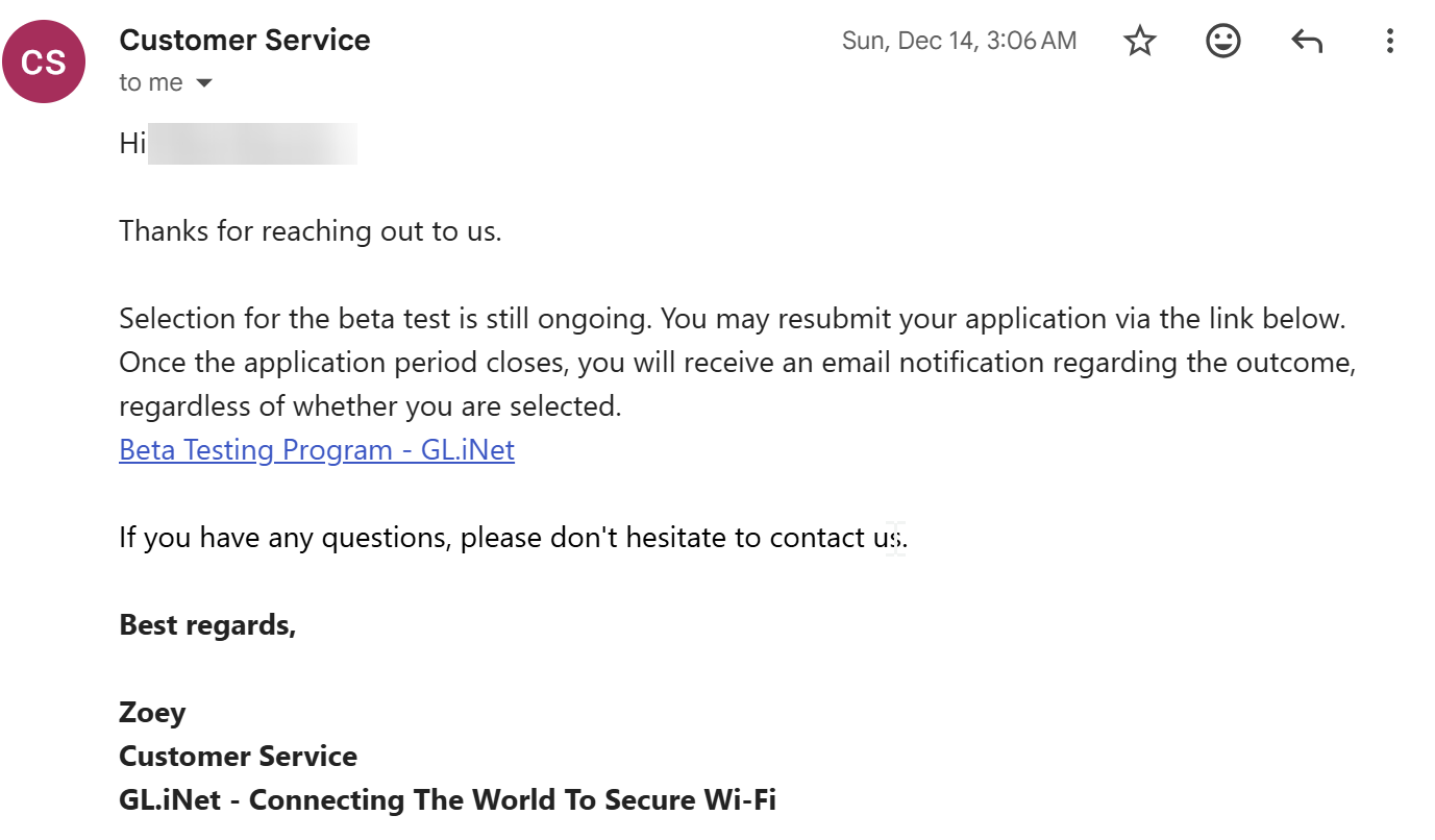

When were emails getting sent out? I was under the impression that we would get emails if we do or dont get accepted. I know at this point that I wasnt, but it is nice to know why we may not have been selected.

If you are successfully selected, you will receive an email; if you are not selected, will not email, sorry.
