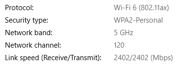

@blackbox - what app produced those WiFi stats in your last post? Thanks.
The first pic is from inSSIDer and the second one is just the network properties area of a Windows 10 PC.
Don’t keep inSSIDer open while trying to browse the web though, since it’ll probably impact your speeds. It’s just good for channel analysis.
