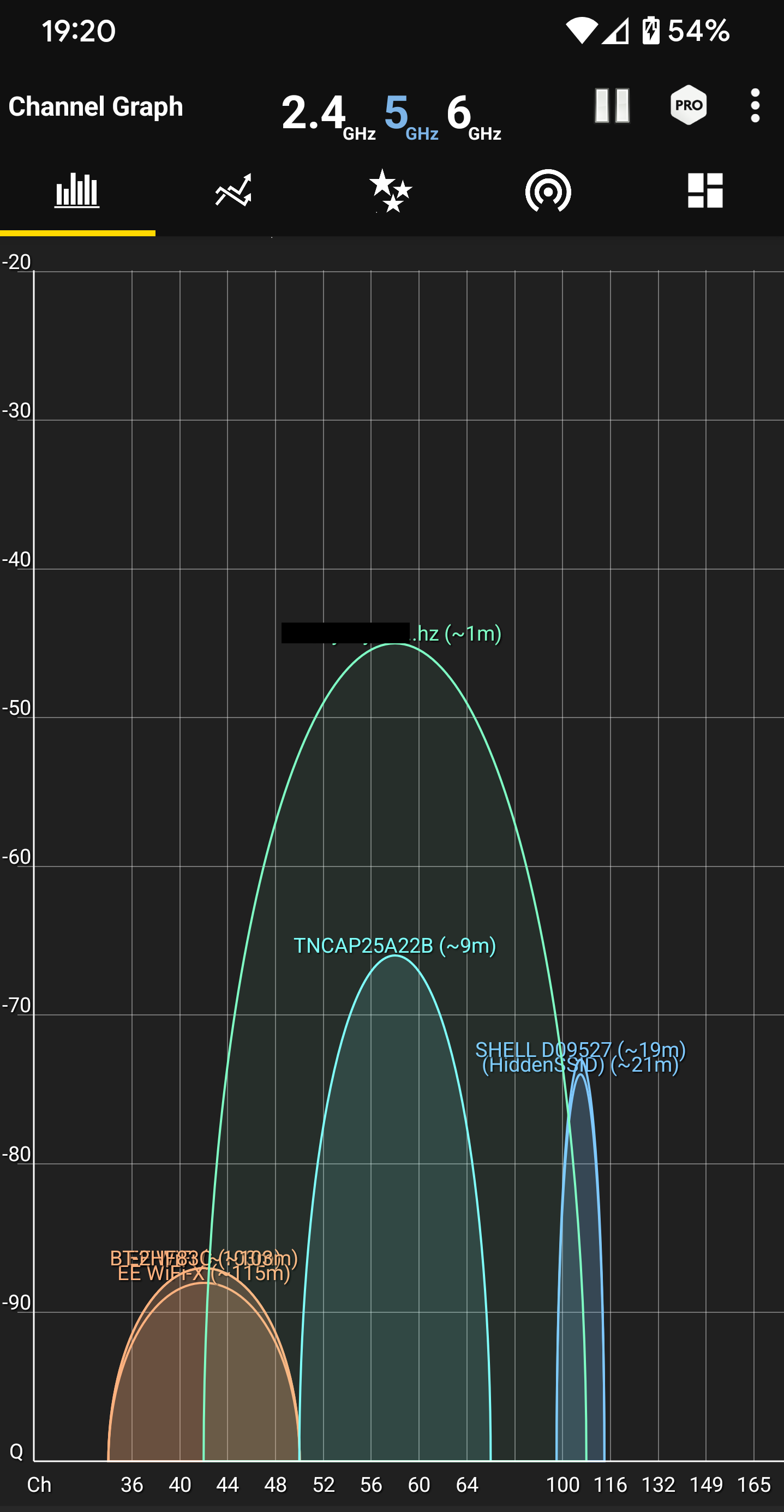

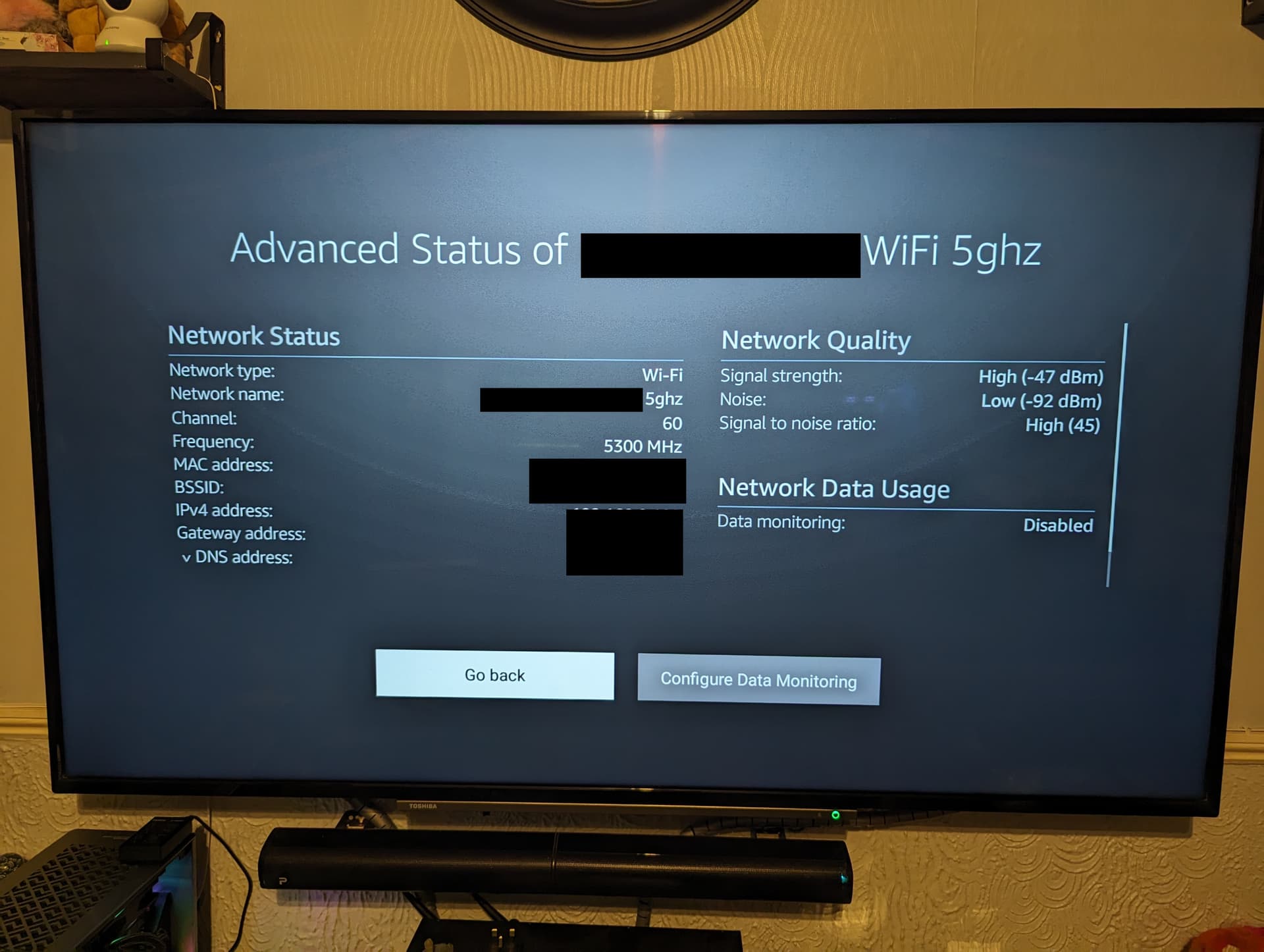

4.5.7 R6 has fixed the issue where I wasnt able to set the country code in Luci
But the same issue where I set channel 128 / 160hz 5ghz is still not working, this issue applies to all of the 100+ channels on this firmware, if I force set channel 64 DFS that works, or channel 60, that works too, but 100, 102, 108, 116, 120, 124, and 128 all scan for about 5 mins or so and then default to channel 40, but it works fine on 4.5.6.

Go to LuCi → Top menu Network → Wireless → Edit your 5GHz network unticking the option “Force 40MHz mode”
Yes, it limits the power of the WiFi and the availability of channels…
I mean, it’s really changing?
Check with the WiFi Analyser (or whatever similar app)
in any app it is limited to 19dbm for 5ghz and 17 for 2.4ghz regardless of what you change. As the dev already commented, it is a bug that has yet to be fixed. If you have any doubts, update there and do your test, put it in Europe and check if it limits the power.
