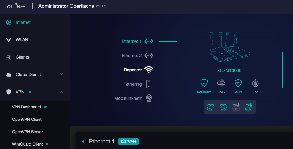

The internet is there, but not the VPN, even though it shows it. The router displays it as shown in the image, but when I test it, only the provider's internet is active.

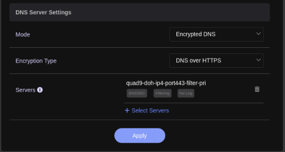

You need to log into your router (ssh [email protected]) & execute:
There's a 'copy' function/icon at the top right corner of that code block. Then you can paste it into whatever you use for SSH software.

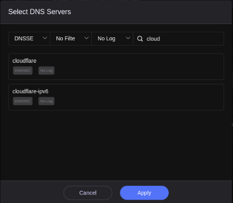

Then, in the GL GUI -> Network -> DNS, change your DNS type to 'Encrypted' -> 'DNS over HTTPS':
That should solve it.

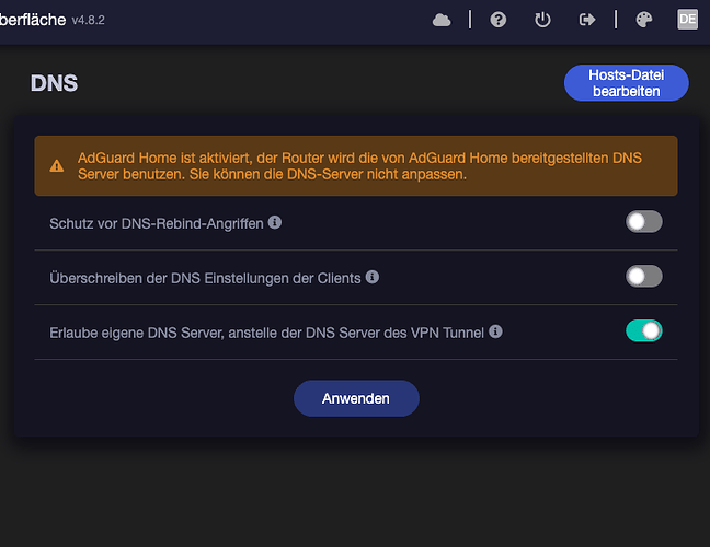

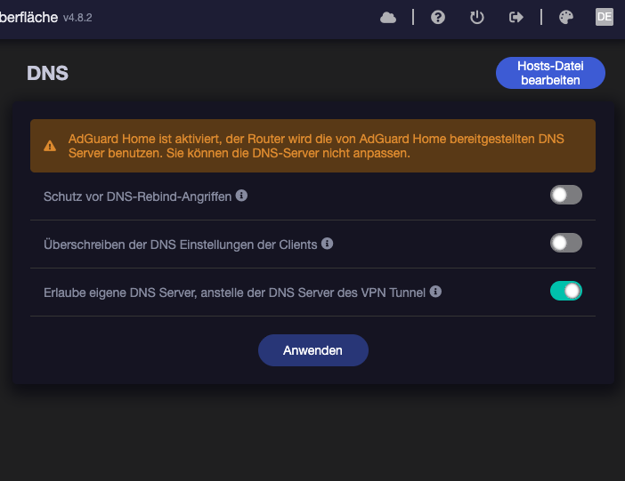

I don't have this option under DNS because Adguard is running:
If I turn off Adguard, the option you mentioned is there.
Ah, I see. I don't use AdGuard Home. You may have a race condition between NTP (to get the proper time via the network time protoco), WireGuard, & AGH's DNS over HTTPS/DNS over TLS.
My advice doesn't account for AGH. Apologies. Hopefully GL staff will eventually see this thread & respond if you're commit to using it.
