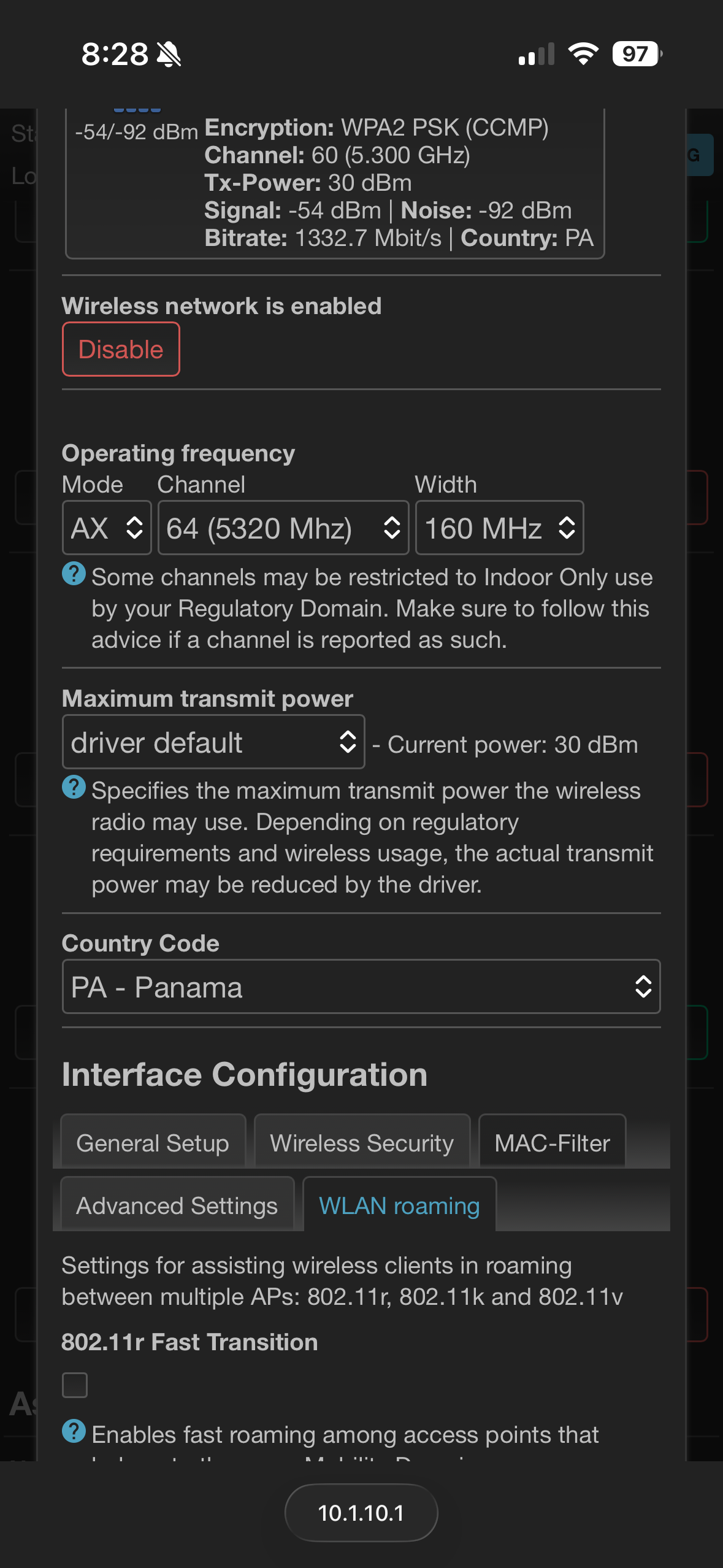

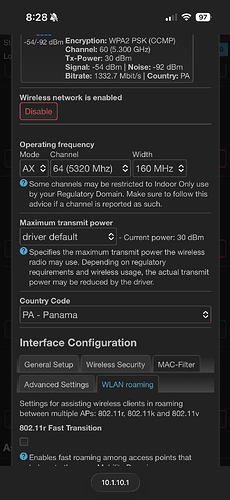

If you’re running plain vanilla OpenWrt, you can just switch the country code to Panama and crank your 5GHz WiFi all the way up to 30 dBm.
Do it at your own risk though. I’m not responsible if you get busted by the authorities, fry your router, or if your neighbor starts knocking on your door xD

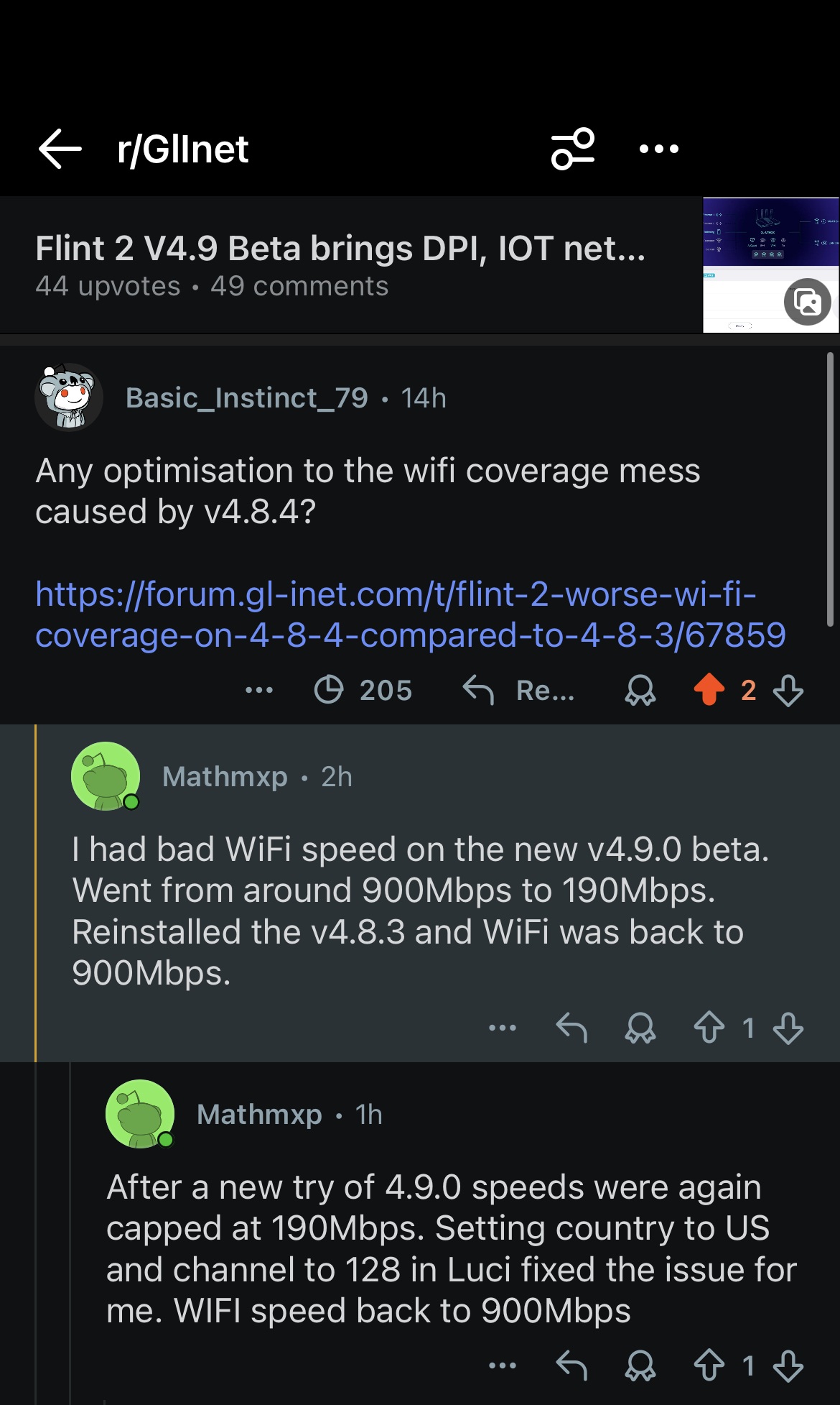

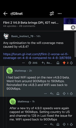

It looks like the worse wifi coverage is present in 4.9.0 Beta as well.
