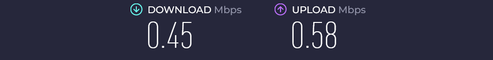

I've been testing and the bug is so weird that I don't even have a conclusion yet, I set both values to 800, this is the result, the upload speed is not being shaped even without a reboot. I'm testing on the MT3000 but applies for the Flint 2 based on my experience, I think it's even worse on the MT3000.
The eth interface is supposed to be always wan-wan6, in this case wan is eth0 on the MT3000. Version 4.6.2 release1
eth1 selected, 800/800
eth1, 1000/1000
eth0 800/800
I rebooted the router, still the same result.
eth1 500/500 (after the reboot)

But why should someone use 500/500 anyway?
Those values are in kbps - so 500 would be nearly nothing. I am not even sure if values like this will work.
We are just testing if it shapes the speed, I know that's not even 0.5Mbps
Any value over 200 should work to test and have an idea, unless you enter 50kbps, things would be harder :joy:
My question is more like "Is it relevant that values <1000 don't work all the time"?
Would be an issue to report to the SQM maintainer anyway, I guess.

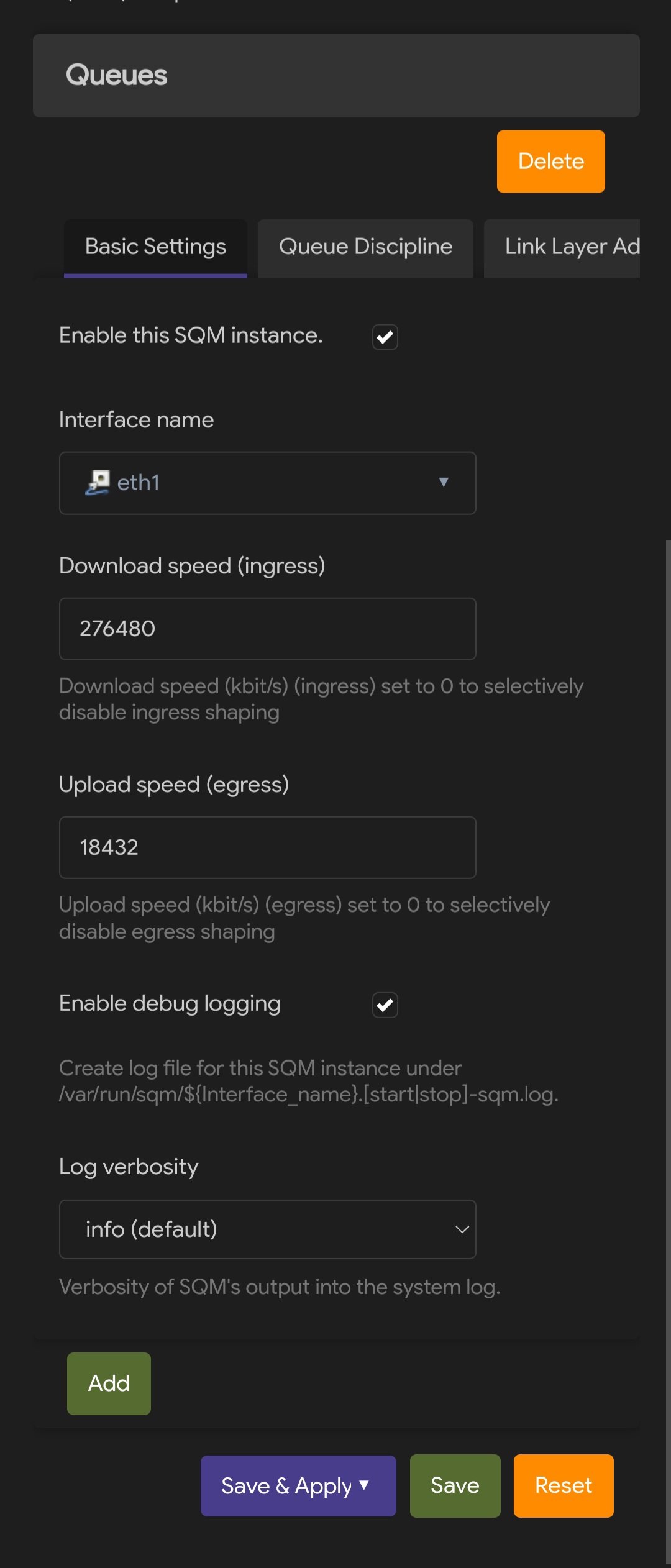

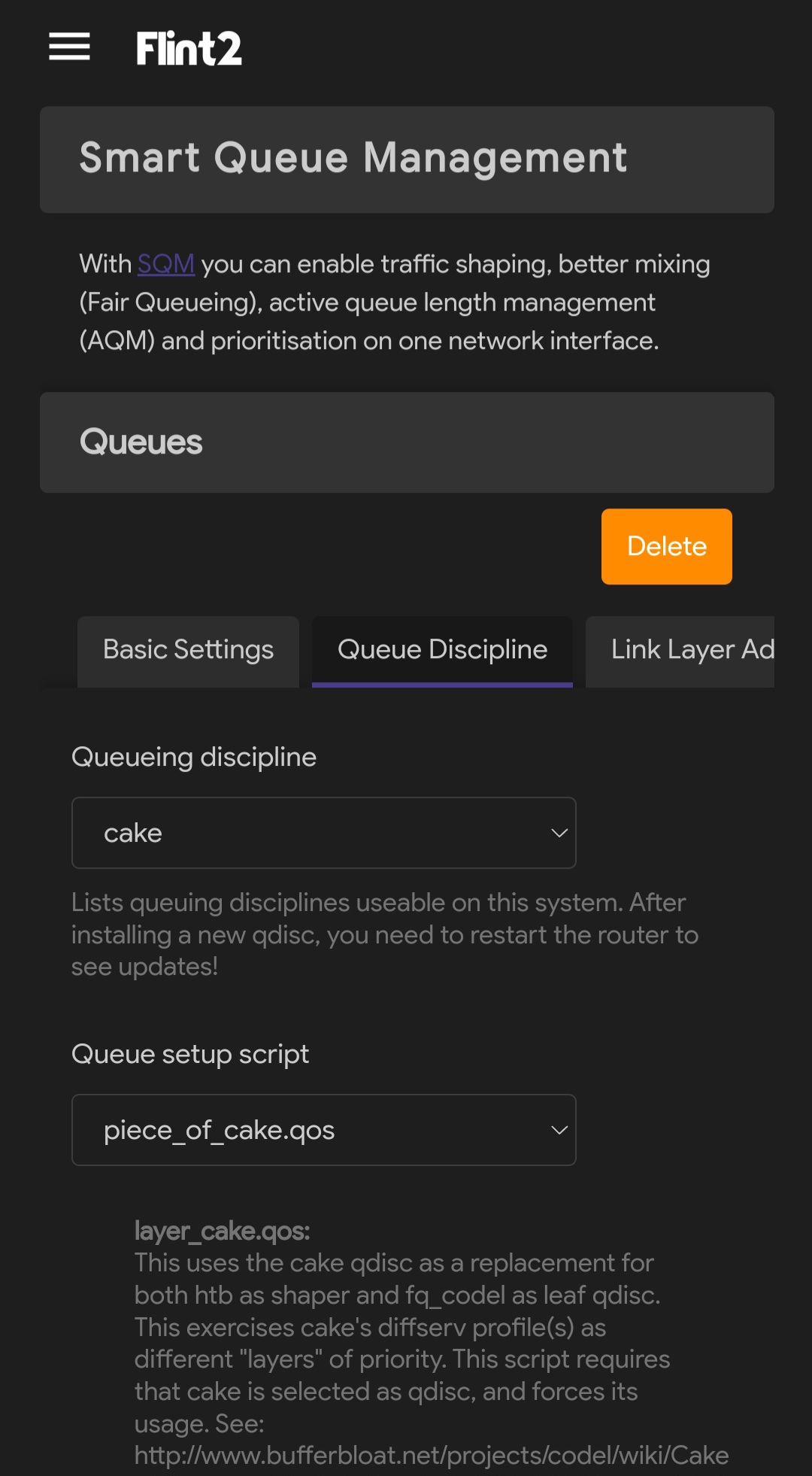

I don't understand what you guys being doing wrong but my SQM it's been working flawless for weeks, my bandwidth/line it's 300mbps/20mbps and this it's my last speedtest:
and this my settings on LuCI:
