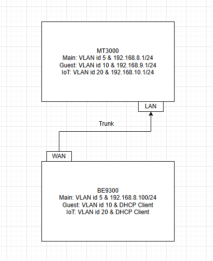

If you just want to create a new SSID for an IoT network on the MT6000, you can refer to the steps below—or wait for version 4.9, where IoT SSID support will be available directly in the GL UI.
However, if you need to use it together with other APs (including another MT6000) while maintaining the separation and characteristics of LAN, Guest, and IoT Wi-Fi networks, the overall setup becomes quite complex.
You’ll need to configure VLANs on the main router/AP for LAN, Guest, and IoT, along with firewall rules to keep devices of Guest and IoT isolated.
Below are some examples from other models/firmware versions with similar requirements that you can use as a reference.

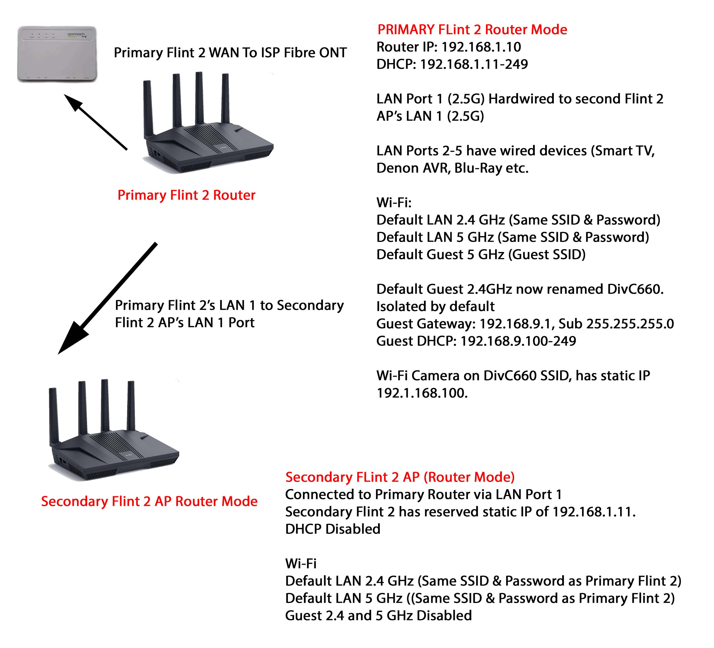

I decided to get another Flint 2 to replace the Archer, but am going nowhere fast.
I totally gave up attempting to create another IoT on the Primary Flint 2. Instead, I just renamed the 2.4 GHz band Guest WiFi, created a subnet and got the camera moved over and created a traffic rule. But as far as the secondary Flint 2 goes, in AP mode it’s useless as it’s not carrying over anything. So it’s just a glorified second router in router mode at present for other wired devices and for providing WiFi for devices at the other end of the house. I have to rely on the signal from primary router being good enough for the camera as I’m stuck as it is.
Spent another 12 hours on this, trying to create devices, interfaces etc and every single time the CPU crashes leaving no access and a firmware reflash is needed to get back in. It would seem these models have some peculiarities that do not comply with much of the advice and examples out there and not being an expert, are far too complicated to follow as they all are for different projects which would make things worse.
My only solution it would seem is to wait for the later firmware 4.9x and see how that goes. But my point is it should be a basic feature to replicate segregation of whatever networks exist in the primary router when using a second flint 2 in AP mode. I’ve not been able to do this whichever way provided as everyone is using different versions of this and that. Not really good enough.

Ok, so apologies if this is over-simplified.
Camera is currently isolated as it’s on the dedicated 2.4 Guest Wi-Fi (DivC660) of the Primary router, which is fine so long as there is a good signal.
I did buy a second Flint in the hope that this could be set up to extend the DivC660 Wi-Fi and maintain segregation, but of course this can’t happen as it is, because it’s my understanding that if I enable the Guest Wi-Fi on Secondary router and name SSIDs and passwords the same, it will just pass everything back via the LAN wired connection and end up getting a 192.168.1.x address from the main LAN.
So my point is why a second Flint 2 can’t just have the option to replicate the Primary networks and extend them, maintaining the same rules and segregation. It seems like it requires rocket science to do this. :slightly_smiling_face:
Let me try to explain why it's more challenging to create different subnets on a secondary router in AP mode and route traffic back to the main router.
First, we need to understand the following:
  1. Wi-Fi is essentially a Layer 2 technology, so it's essentially the same as Ethernet, but without the need for cables. We can still think of it as a special Ethernet port.
  2. A secondary router running in AP mode is essentially like a switch, only responsible for forwarding traffic from other ports to the upstream port connected to the main router. So, without special configuration, the secondary router will simply extend the network of the upstream port (typically the Main network).
Therefore:
  1. On the main router, we can easily create different wireless networks (Main, Guest), just by creating different subnets and assigning ports to these networks.
  2. But on a secondary router in AP mode, since it acts like a switch, if we want to segment different subnets and route them back to the main router through the upstream port, we need to:
    • Use VLANs to segment the network
    • Configure the upstream port as a trunk port
  3. Since the secondary router in AP mode uses VLANs, the main router will need corresponding adjustments.
Regarding the help with configuration, do you prefer:
  1. For us to provide the Luci/UCI configurations based on the current firmware version?
  2. Or as you mentioned earlier, would you like to wait until v4.9.x, when we add support for IoT and VLANs in the GL UI? By then, most of the configurations should be available through the GL UI, and there should be no need to deal with potential conflicts after firmware upgrades.

Thanks Will, have sent an email to support (Ticket 108320). The attachment within should detail existing and required simplified setup.
Thank you for the update.
We will review the topology shortly and provide an update through the ticket system.
Just to update and close this off for now, remote support session created all the networks, but unfortunately as happened before, lost all internet access on Guest Wi-Fi. So I decided to abandon the project, given the disruption to my Homekit devices and cameras after a day of setting the SSIDs and reconfiguring all my smart devices.
Had to refresh firmware and restore from a configuration backup to get back to square one. I decided to leave this until Firmware 4.9x is officially released, before attempting this again, as there is clearly a problem at present. Support did offer to assist further and troubleshoot, but given the constant issues I decided to abort it for now as I needed to get everything back up and working.
