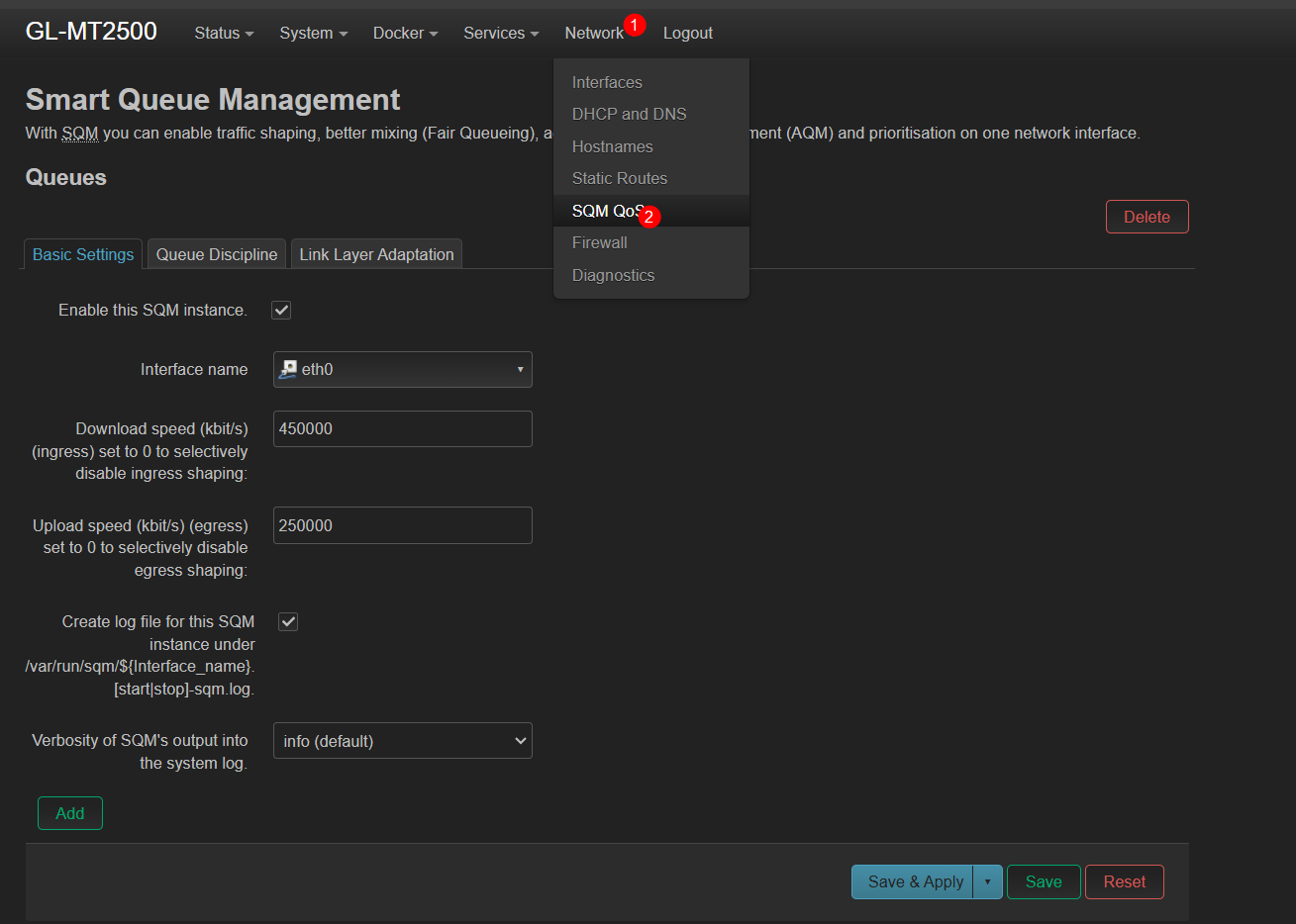

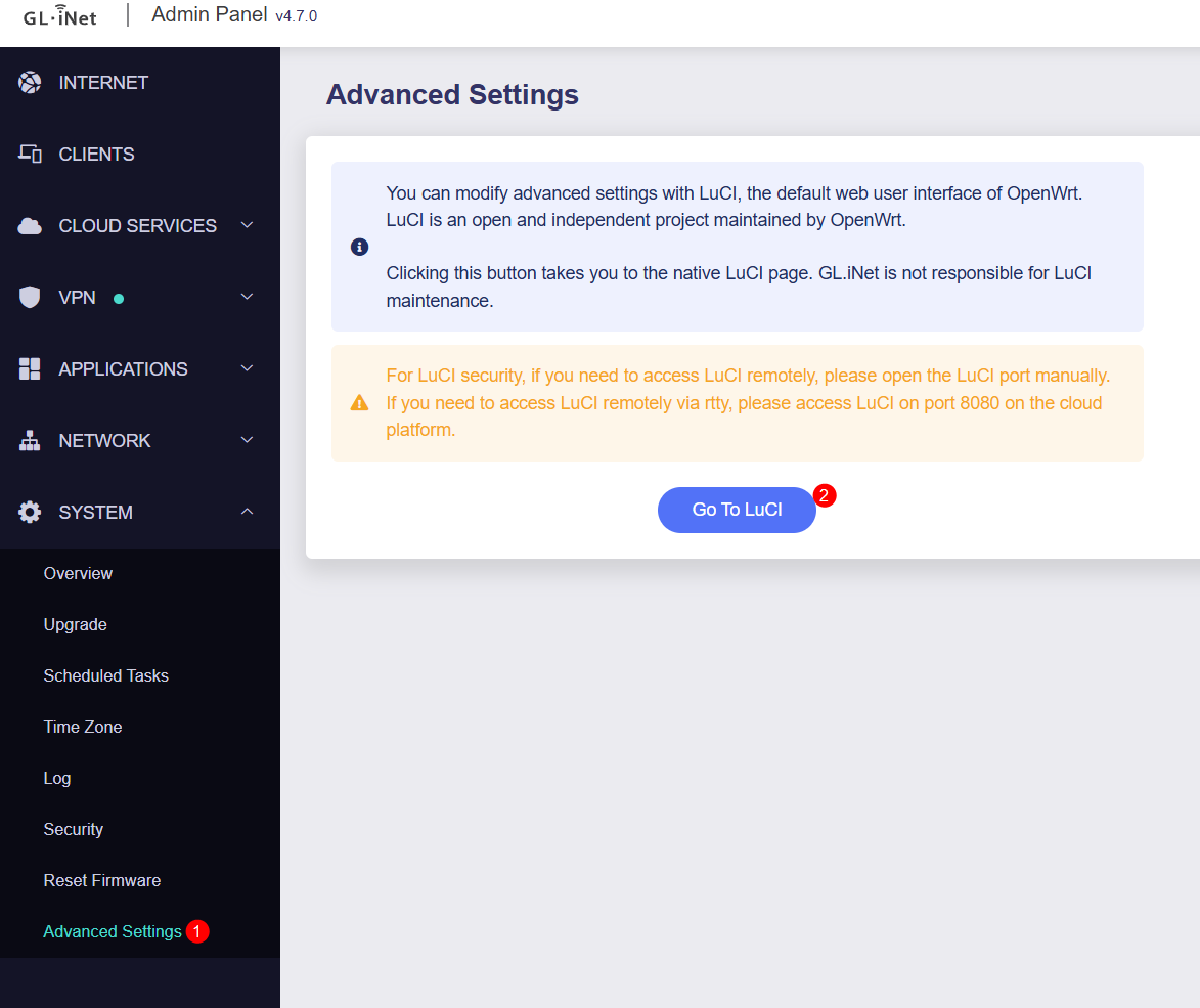

I'm not sure about marble with SQM, but I can tell you how I did it in Berly and Brume 2. I went through the APP/Plugin page and installed the Luci add-on, and that worked for me.
You can make the config in Luci page:
And there you can config it:
