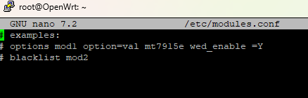

Normally that line goes at the end of the file. But youâd need to reboot your router and then you can input cat /sys/module/mt7915e/parameters/wed_enable into PuTTY. If it returns Y then itâs enabled.
