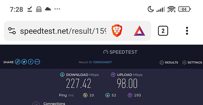

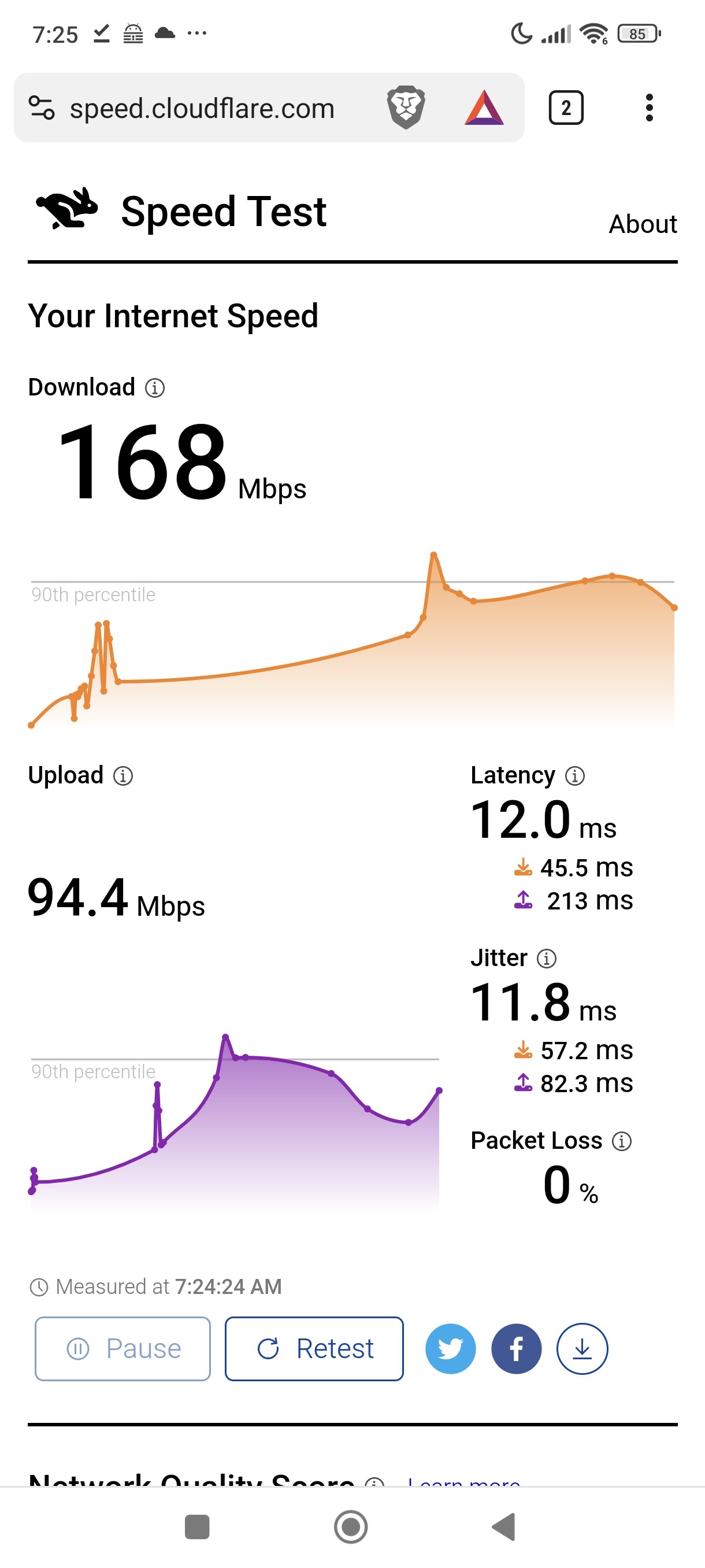

Anyway speedtest on cloudflare on my 2.4ghz network:
This is from around 15 meters away, the upload may be on a low side but need to recheck this a bit closer.
speedtest reports:

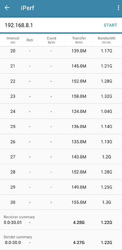

I’m getting impressive iperf3 results reaching upto 1.32 Gbit when using my Pixel 7 and running the iperf3 server directly on the GL-MT6000.
5GHz, 160MHz + irqbalance enabled (but i don’t think irqbalance makes a huge difference).
The Wireguard WiFi speed is with the Pixel 7 better compared to my AX210 WiFi adapter.
The LAN Wireguard speed is still the same and reaching upto 850 Mbit.

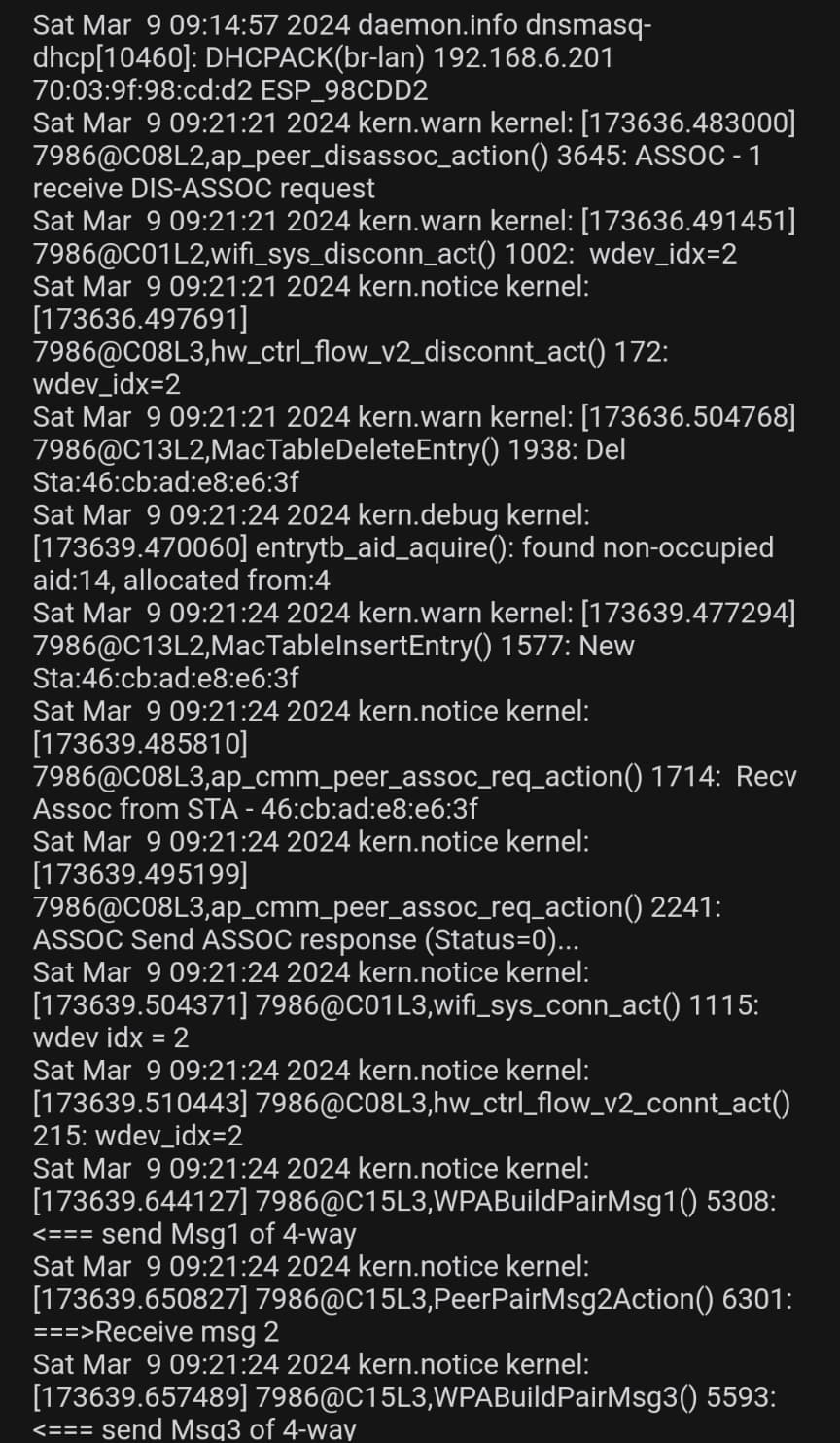

My Google Pixel 7 is going offline and online again by no reason, randomly.
