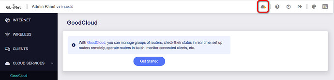

Not sure if this is a bug but I cannot allow remote or SSH access to router using GoodCLoud as it does not give me the option to do so at all.
Tried disabling and then reenabling cloud access and also removing and rebinding device to no avail. The router is showing up as being connected on goodcloud’s dashboard.
