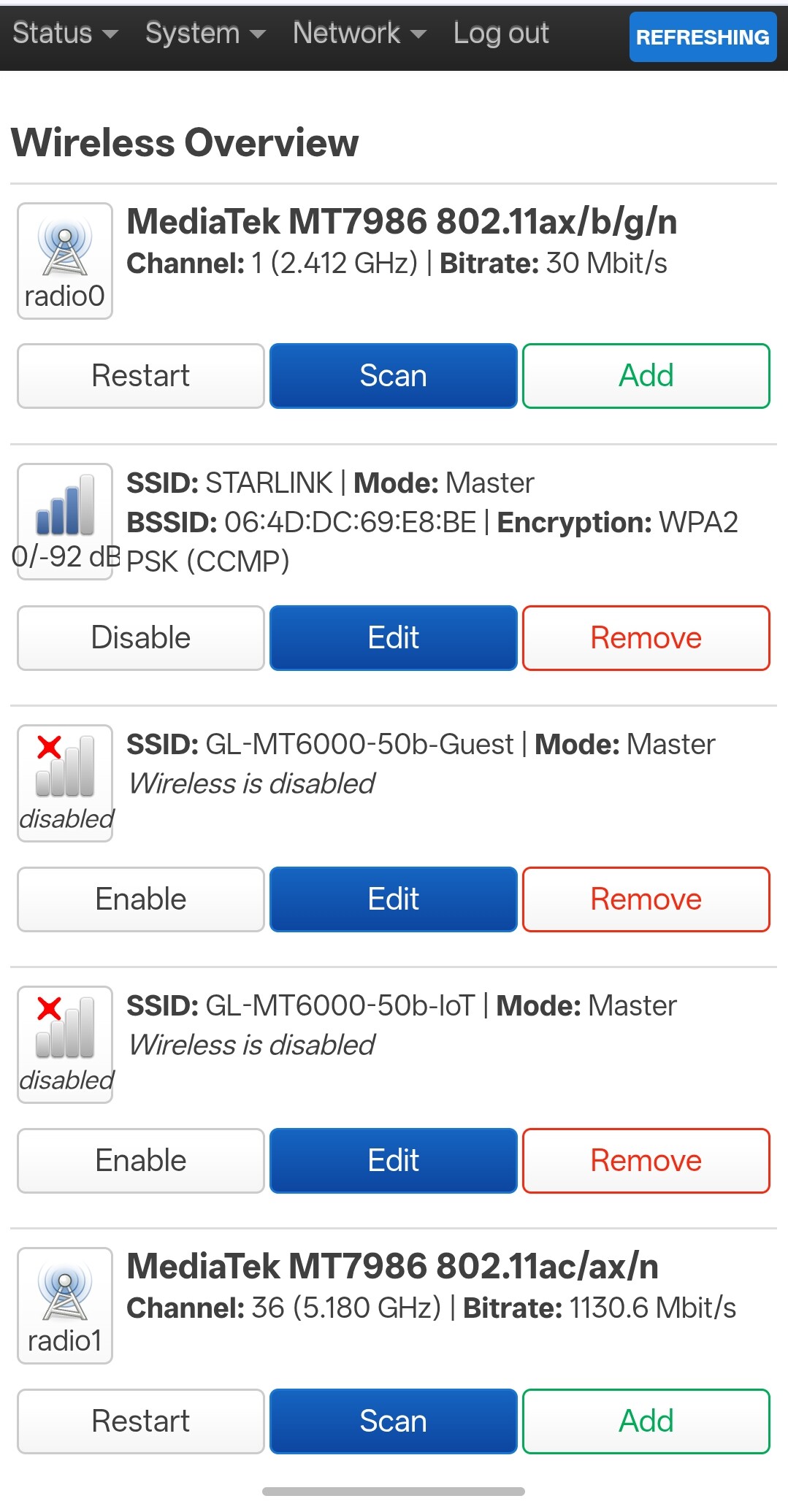

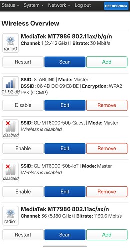

I'm dealing with an issue in flint2 in openwrt version 25 beta3 which was also present in beta 2. The bitrate is extremely low and at 2.4 and 5 ghz, 30 mbt from 576mbt which would be normal at 20 mhz does anyone else have this problem?
@argvas The 54 Mbit/s shown at the top does not refer to the maximum speed of the 2.4 GHz band, but rather to the current PHY rate of the radio interface (radio0).

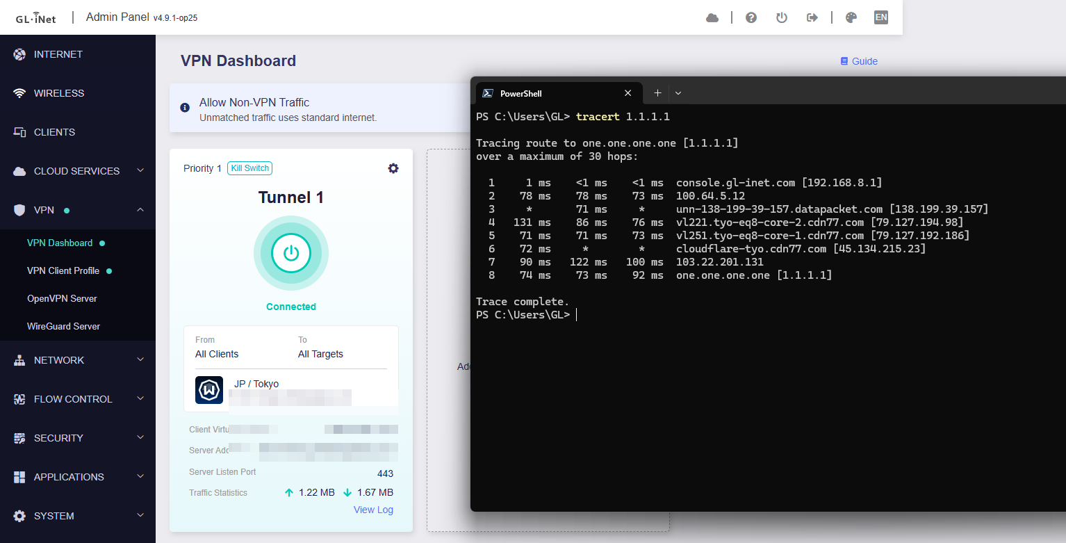

Debug version worked quite well for few days with no significant issues. Clean-installed OP25 Beta 3 for the flint 2 just now and as soon as VPN client is on, the internet connection goes dead. Looks like this version is still far from prime time.

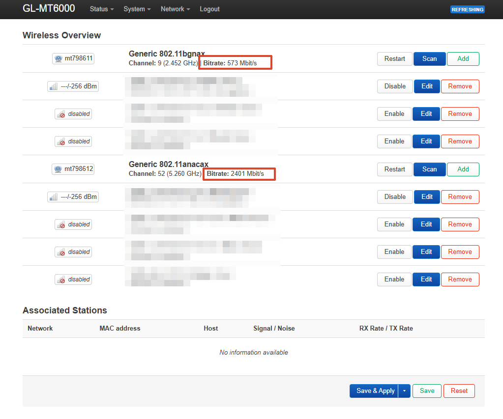

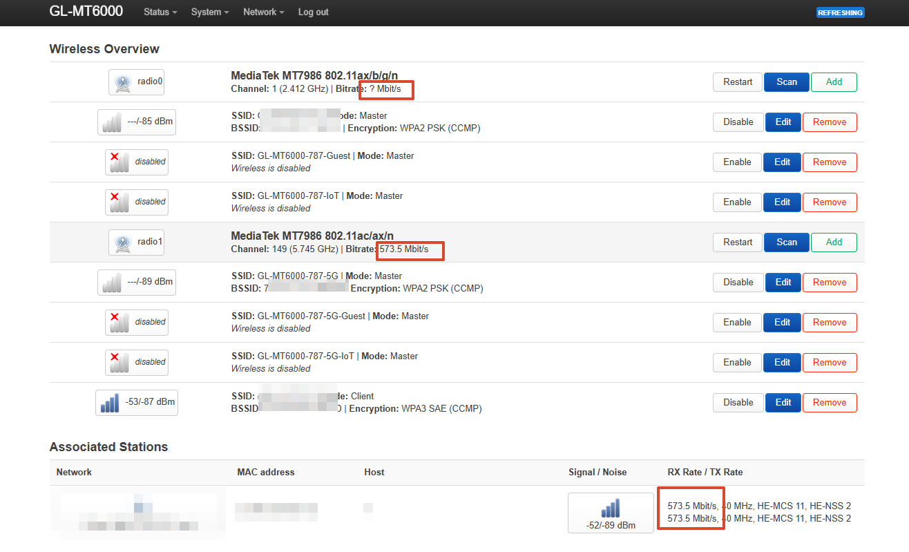

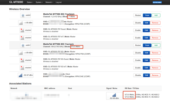

The Bitrate display logic in Luci Wireless is different between OpenWrt 25 (or Vanilla) and the proprietary firmware (MTK SDK):
  • OpenWrt 25 (Vanilla) shows the highest negotiated rate among the clients currently connected to the corresponding band (2.4/5/6 GHz).Please note that this information is not synchronized in real time, so the displayed value may vary from the actual current rate.
  • MTK SDK shows the maximum theoretical rate that the current band configuration can achieve, regardless of whether any client is connected or what the actual negotiated rate is.

However, we tried reproducing the issue locally but were unable to reproduce it.
Could you please try again? If the issue still occurs, could you provide the steps to reproduce it (for example, the VPN-related settings, VPN provider, and other relevant configurations)?
The problem is not that it appears in a different way: In the stable version 4.9.0 at 2.4 ghz it shows 1148 bitrate and I was reaching a speed of 280mbps, in the openwrt version 25 beta3 it shows 60 bitrate and the speed I get is 120 to 160 mbps.

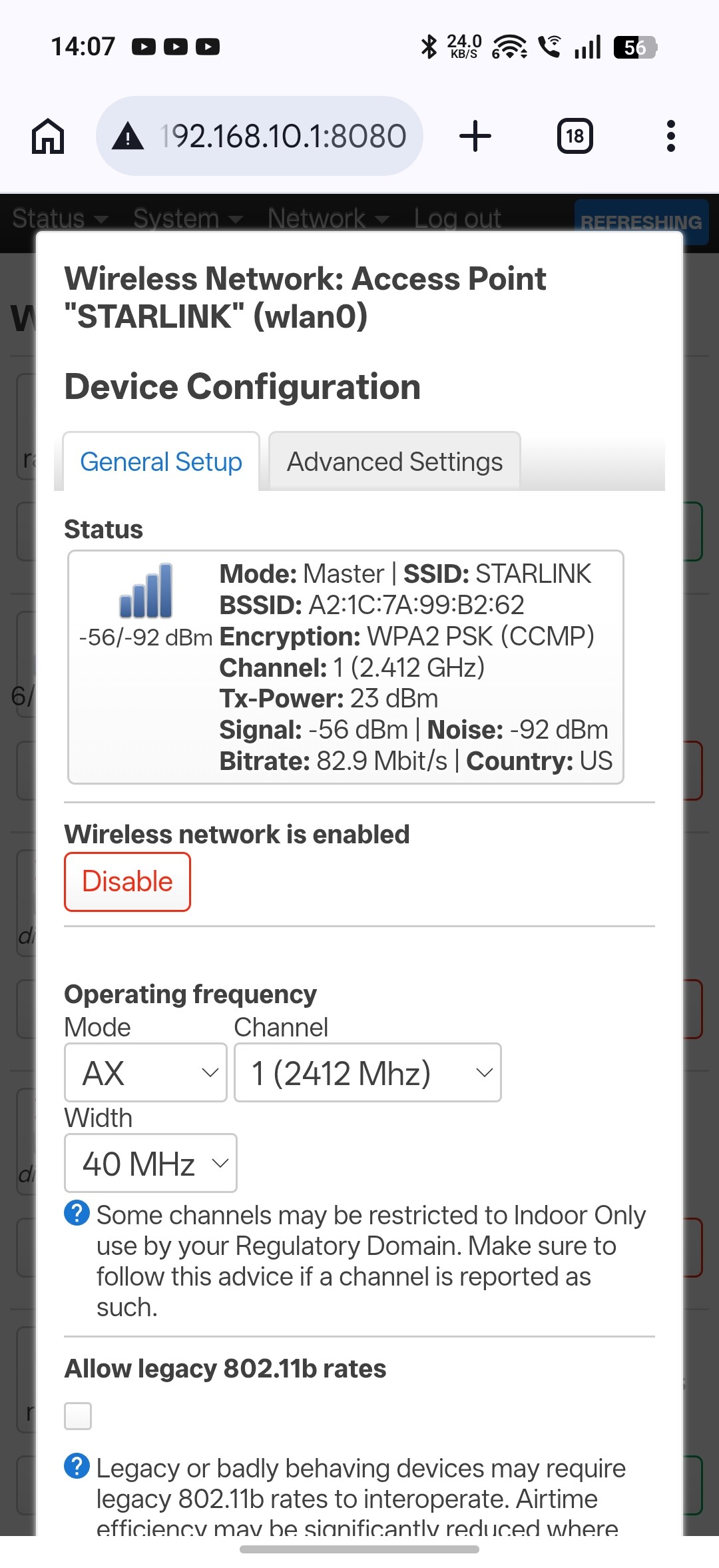

Right now I'm back back to stable 4.9.0, and everything is flawless.I also notice a huge difference in noise notice 55dbm In stable version 4.9.0 and 92dbm noise in openwrt version 25 beta3
The performance has a huge deviation in 4.9.0 at 2.4 my speed is 280 with 320mbps in the openwrt version 25 beta3 up to 80mbps. It is clear that with Vanilla drivers that the stable version 4.9.0 has works flawlessly While at openwrt25 With media tek drivers there is an issue
