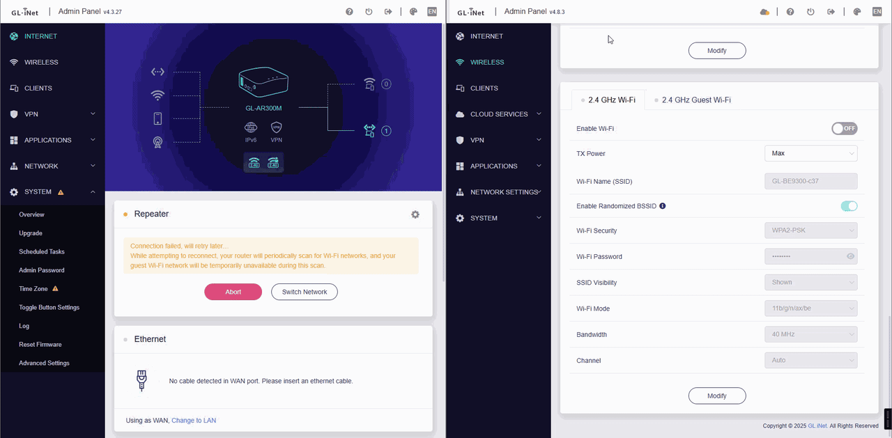

As mentioned in the previous thread, we were unable to reproduce the issue in our local testing. We have conducted a similar test again:
  1. Connected the AR300M to a network (in this case, the 2.4GHz SSID of a BE9300).
  2. Turned off the BE9300's 2.4GHz SSID and rebooted the AR300M.
  3. Confirmed that the AR300M still attempted to connect to the BE9300's SSID after startup.
  4. Left the AR300M idling for approximately two hours, then re-enabled the BE9300's 2.4GHz SSID.
  5. The AR300M was able to automatically reconnect.
    output
Could you please check the following on the devices that fail to reconnect automatically:
  1. Check Repeater Status: Access the Admin Panel and check the Internet section. Does the Repeater status display "Connection Failed, will retry later"?
  2. Export Logs: Please export the system logs from the device and send them to us via private message so we can investigate further.
