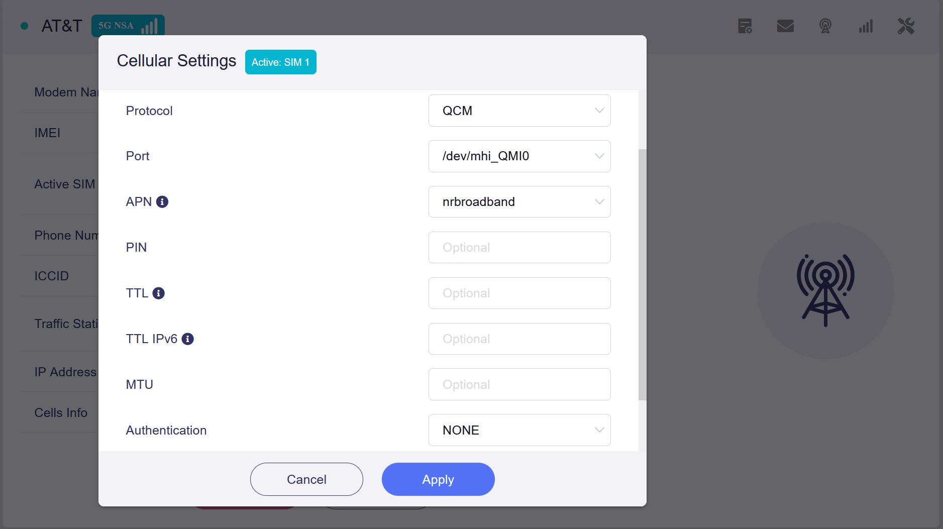

In downtown Denver (now has an extensive 5G buildout), I’ve been on a 4G LTE then 5G Unlimited plan through an AT&T MVNO (reseller) for the past 5 years. Swapping the SIM from a simple hotspot to Netgear M1 (4G LTE) then the M5 and M6 Pro (5G) I always received the expected 4/5G service.
I bought the Spitz 5G, verified its the latest firmware, swapped over my SIM, but cannot access any 5G towers with it.
I’ve exhaustively tested every possible combination of the following IMEI’s and APNs, with TTL’s 64 & 65, and band locking to either only LTE or 5G bands, both with factory Spitz 5G antennas and a Parsec 5G Husky antenna. I restarted the device between each change.

In my findings the IMEI, the TTL and antenna’s don’t make a difference in access.
“broadband” is the only APN that works at all, but won’t access 5G bands.
The other APN’s left me with the “connecting” banner, and with any of them if I prevented LTE band access, they had the banner “SIM card unregistered.”
I assumed my $120/mo MVNO plan was the “tablet plan”, but to be sure I signed up directly for the $20 “AT&T Unlimited Tablet” plan with my iPad IMEI, and tried that SIM card in the Spitz 5G with the extensive combinations listed above. Same findings, but I learned I can save $100/mo for the 4G LTE I’m getting…

@flyrmyr I’m on the “AT&T Unlimited Tablet” as well. I had the same situation of only getting 4G because the device I signed up with (iPad Pro 4th gen) doesn’t have 5G. Once I got an IMEI for a 5G iPad, I called customer service and had them update the IMEI on the account. Once that was successful, I was able to connect to 5G using ‘nrbroadband’ for the APN. Before changing the IMEI, ‘nrbroadband’ didn’t work at all. Hope that helps!
I also have the AT&T unlimited $20 4/5G tablet plan and only can get 4G. Where did you get the 5G IMEI? Pretty sure thats what i need. My tablet plan started on an old iPad Air with no 5G.
@contactprinter I purchased an iPad Pro M2 & using its IMEI with the plan. Any 5G tablet would do.
