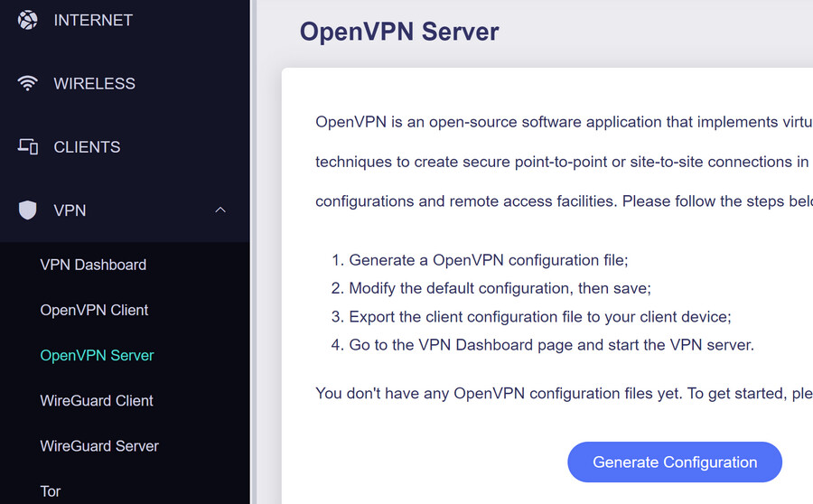

can i use open vpn server in gl-inet?
Yes, Definitely you can.
Gl-inet openVPN server and Gl-inet openVPN client both solve this tapo issue without using any third party paid service?
