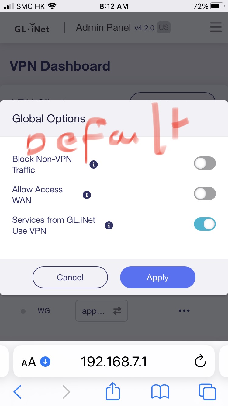

I also tried various combinations of the GLOBAL Options. No go.
