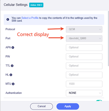

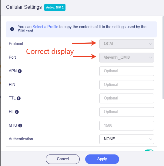

If, after updating the X3000 as per the instructions at the top, the Port and Protocol details on the cellular settings page are incorrect, the device may be running an old hardware version.
It's recommended to download the new bootloader from the link below, update the U-boot and firmware version and try again
https://fw.gl-inet.com/firmware/x3000/uboot/uboot-x3000-20250328-2c152d7aad44678ec7411b551ce5c7b0.bin

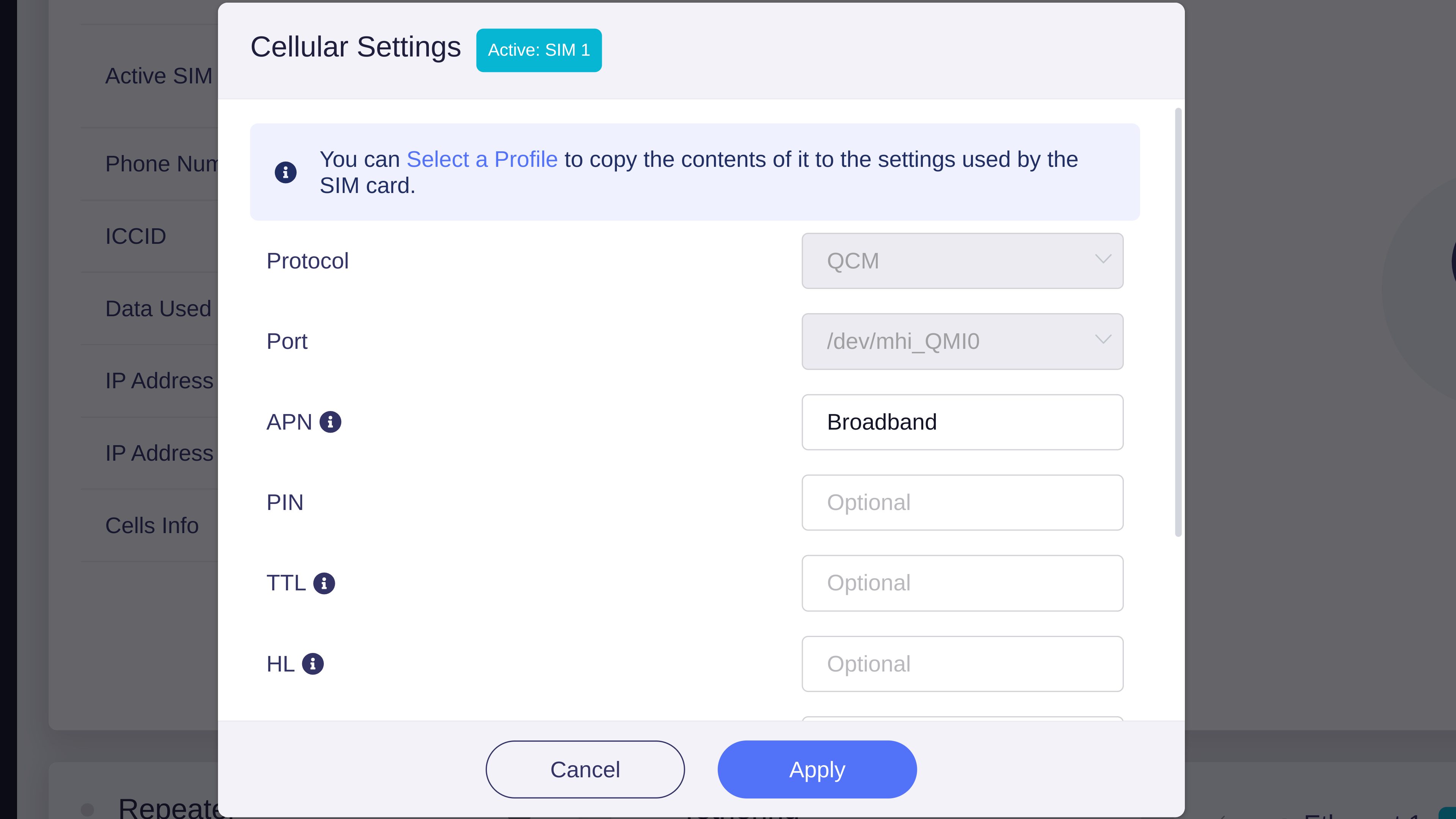

Cellular data show correct info. Do I have the old hardware? I don't have any way to hook up to the Lan/wan port to my Chromebook or phone so installing uboot separately isn't an option. I can only use the USB port which I'll assume doesn't work for uboot. Bought July 10, 2023 from Amazon USA

I think not. We improved the time sequence with some minor hardware changes.
Thanks! Good to confirm I don't need to update anything on the OpenWRT side.
I can confirm that my x3000 (ordered 11 May, 2023) worked just fine with the U-Boot version in the first post. I have not tested with a sim card but the Protocol and Port displayed as Cathy specified in her post.
