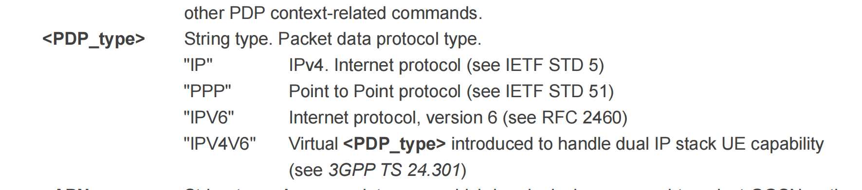

Here is the AT command manual for RM520N
Quectel_RG520N&RG525F&RG5x0F&RM5x0N_Series_AT_Commands_Manual_V1.1.pdf (1.6 MB)
Command AT+CGDCONT can be used to set APN, where the parameter PDP_type is used to specify the connection via v4/ v4v6.
