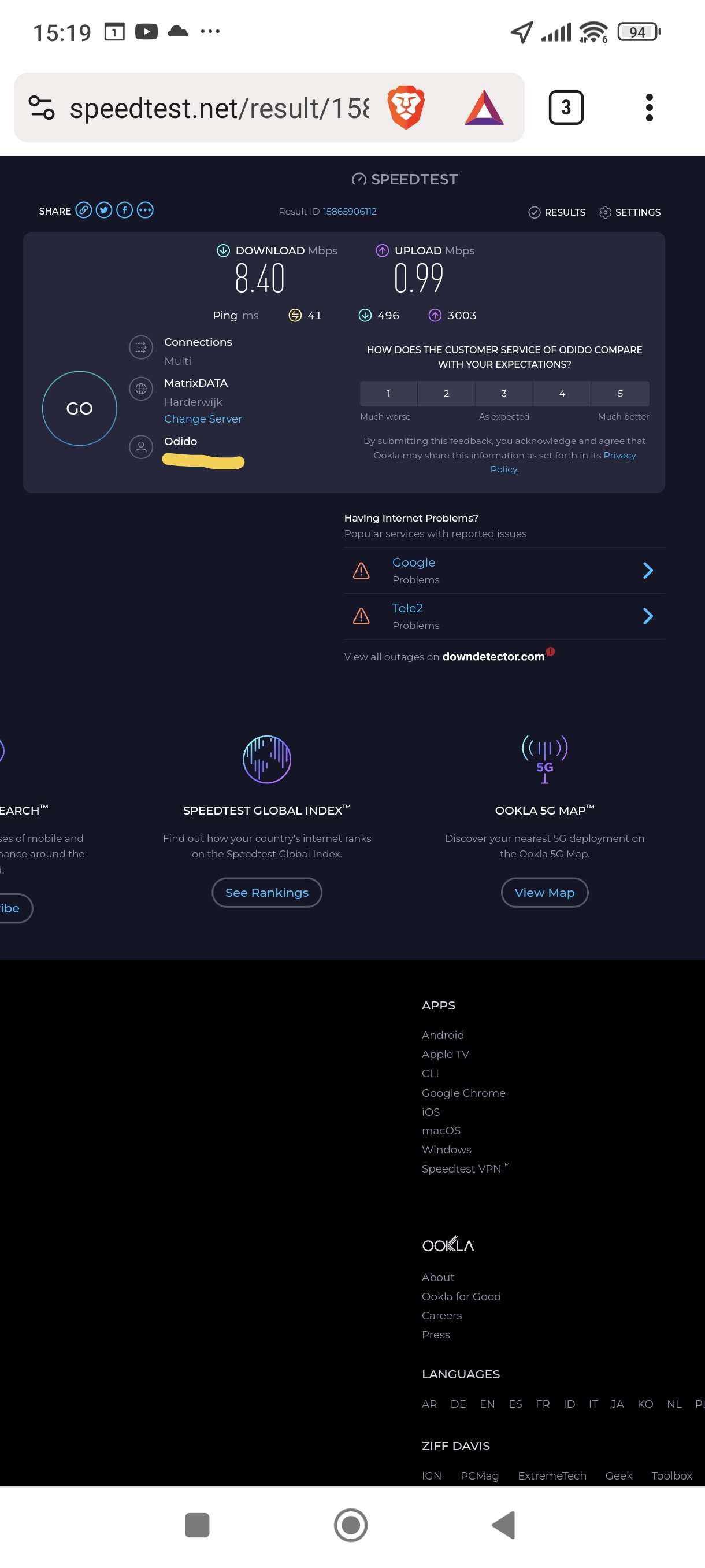

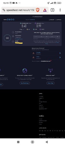

Today i went out of my appartment which is the 5th elevation and went a few meters outside of the building, with the wrong firmware i had on the last stair only 1 bar.
But with the mediatek sdk i got around 3 to 4, similar as with the flint 1.
I did a speedtest:
Its okay that the speed and latency is not fast because its really far away, this should be kinda expected.
The only thing i did notice was that 5ghz was a little bit faster, but to be honest with the Flint 1 this signal was gone.
