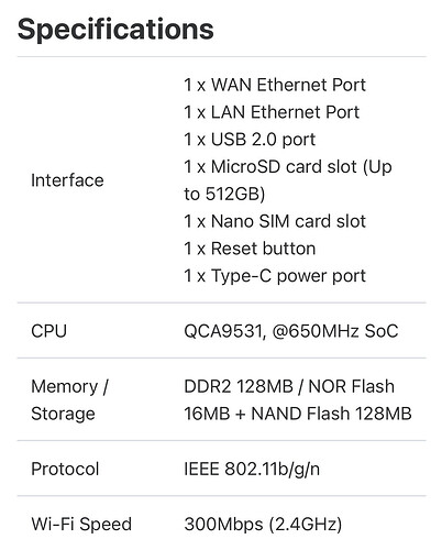

I urgently need to install AGH to this device. It has “1 x MicroSD card slot (Up to 512GB)” maybe I can install it on SD? Or make it in system memory but cache on SD?
I need to preserve GL GUI…
Please help!
Please help!

I won’t be so sure. The main reason for not pre installing I think - lack of memory. Purely theoretically it should work.
By the way GL engineers reply needed.
Nah, just testing required. As we can see within many threads AGH needs many resources, at least while updating the block-lists. I would guess it will work fine as some DNS-proxy, but not as a real ad-blocking service.
