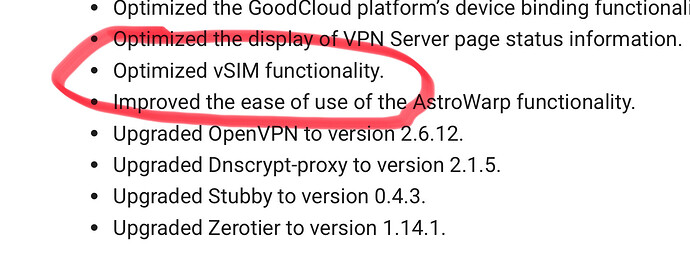

The release notes for Beryl AX MT-3000 beta 4.8.0 refer to a vSIM.
Whilst these routers list those that support eSIMs, (whic doesn’t include the Beryl AX) if the MT-3000 has vSIM support, how does that work exactly? You can put it in some sort of a USB Dongle? That would be awesome, but I get the feeling this is a typo from another change log.
I can only find references to vSIMs for the MUDI devices.
Hi SmurfonToast, sorry for this mistake, our products use a release note, this vsim function is for X3000/XE3000/E750 device what use Skyroam module, not for standard device, so it is wrong. for our customer, they can use this function with E750 vSIM verison.
