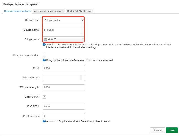

  1. Please log in to Brume 3 and go to SYSTEM → Advanced Settings → Go to LuCI → Network → Switch.
  2. Go to Network → Interfaces → Devices, create a bridge device, and add eth0.20 as its bridge port.
    Note: Please use br-guest as the bridge device here.

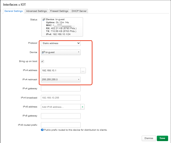

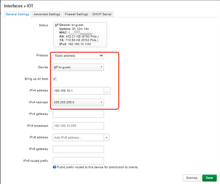

    Then go to Network → Interfaces → Add new interface and create a static interface for this network.

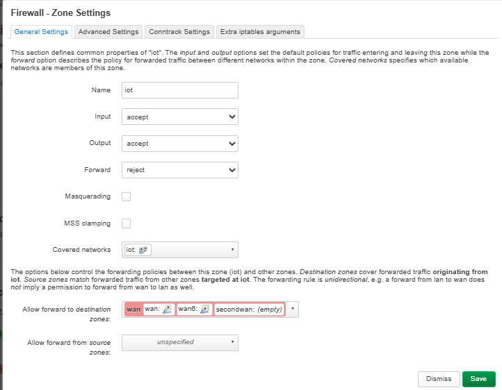

  3. Create a separate firewall zone for the IOT interface.
    Then save and apply.
